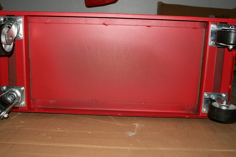

My bench surface is a 2" thick solid core door -- with some steel edging along the front of it. My plan had been to re-use some of the old understructure from the previous bench when I put this new cabinet in, but the cabinet seemed plenty strong all by itself. So I have some facade-type pieces on there (to cover up my air hose reel) and some steel L-brackets connecting the door to the wall and also from the door to the cabinet (so it won't lift up -- I used the threaded mounts that would normally support the push handle).
But yes, the cabinet is bearing the weight of the thing. I put 2" thick lumber pieces underneath it and 5/8" thick pieces on its top, since there's an edge piece that goes around three sides of the top of the bench that I didn't want all of the weight to rest on.

33-1/2" without the wheels.
I had to fill 35-1/2" under my bench top -- it's a strong enough cabinet to do most of the support for a bench -- and I cut wood sections to go underneath and on top of the bench.
