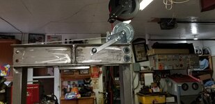

A couple years ago I bought a HF 20 ton press, part number 60603. Subsequently, I made a number of modifications and improvements that made it much more user friendly. I've had quite a few questions about it, so I decided to make a short video explaining what I did. I hope you guys find it useful.

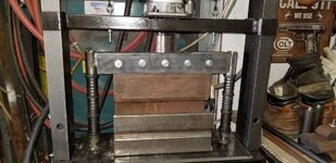

Sty57
Aug 4, 2015
20
Very nice!
I've been doing a lot of the same things on mine.
I'm still trying to get it finished up.
The break press should come in very handy around the house.

Sty57 - nice work. I see you have reenforced the top cross brace above the jack. That seems like a pretty good idea. I can see how that area could possibly flex under a severe load. I may do that too. Thanks.
Sty57
Aug 4, 2015
20
I actually dropped a piece of C-channel
Down in the top plus put the gussets on the outside.
Then I welded it all up.
It's probably Overkill but better to be overbuilt. Then have it fail.

That is one beefy looking little press brake! Can you share the details?

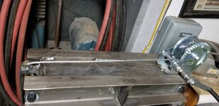

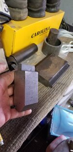

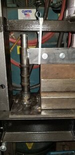

Sty57
Aug 4, 2015
20
The 4-way and top dies I cut off some old dies we had at work.
The rest is just scrap steel I had laying around the house.
I cut a couple different lengths of top dies so I can change them out. They are just sandwiched in-between some flat-stock.
I will make a few different top dies as needed.
The springs are some old RB Mopar valve springs I had laying around.
The whole thing is removable in a few minutes and I can use the press normally.
I need to finish up a shelf on the bottom to store it all when not in use.

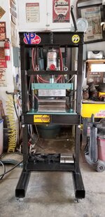

Sty57
Aug 4, 2015
20
Shelf done enough for now. Looks like I'll have to trim the sides of the brake base so it sits down flat. But that will have to wait.
Mama is yelling at me to get ready for Easter.

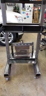

Sty57
Aug 4, 2015
20
Finished up mine this afternoon.
It's good enough for who it's for. LoL
