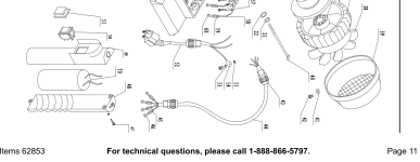

I just picked up 3 of the HF Pittsburgh 1300lb electric hoists model #62853. I need to extend the remote control cable on all of them since they will all be installed 14-18 feet off the ground. I AM NOT AN ELECTRICAN and a complete novice when it comes to electrical work. I want to do this as safely and easy as I can. Rather than replace the entire cable and hookups at each end, I would like to just cut the original remote cable in the middle and splice in a longer section. Questions for those that know way more about this stuff than I do…
Any reason this shouldn’t work or that I shouldn’t do it this way?
What EXACT type of cable/wire do I need to get?
Any special steps I should take?
Thank you for any feedback.

I don't recall the number of conductors in the cable, I think mine was 4.
I would find the length of cable you want, and just replace the whole cable, vice splicing in an extension. Fewer connections to be made and you're relying on new connections only in the control pendant or the existing connection box on the hoist, vice splices on the cable itself (which in my case would be hanging, and more likely to ge pulled on). The cable gland or grommets should be reusable.
You'd need some new spade connectors for each end but overall a pretty simple modification.
I think 14/4 SOOW or SJOOW is the type of cable and would be sufficient.

It's definitely 4 conductor. Sorry, I have done 2 of these, but I can't quite recall the gauge. I want to say 14 This is mostly a special order SJ cord, but some HD's have it in stock (maybe). Just look closely at the cord on your hoist, and use the same gauge #.

I'm not saying I know any more about this than you do, but if it were my hoists I'd replace the entire cable with a new longer one of at least the same gauge wire.
Also, it may not matter to you but be aware you will likely be voiding the warranty on the hoist.

I think the smart move is to replace the short cable with a longer cable. Every connection is a potential failure point and give that the control is going to be hanging from this cable I can’t imagine a splice that would distribute the pull evenly among the 4 conductors. Is the plan to put the splices in boxes or are you just going to wrap them up in a pile of tape?

You can cut out a section of cable and take it to a supply house and have them sell you a new length, using the parts still connected as a pattern connect the new cable. It dosen't really matter if the colors on the new section are not the same s the old, just be consistent in how you choose which color replaces another.

looking at the manual it looks like one end of the cable is spade connectors and the other is eyelets or Y. As suggested get the same gauge wire and fabricate new cables. If the unit fails in the warranty period, just put the old cable back on and take it back. If you cut it they won't warranty it.

I would think about buying a new cord for one hoist and then cut the cord you replaced in half to extend the other two cords.
I think the housing end is easier to change than the control end. I would twist, solder and heat-shrink.
How often and how many people will use them? I would add a 1/16" wire rope from the control to the housing to relive the stress, and in case some knucklehead tries to pull the hoist with it. I also put the control in a good plastic bag and tape foam around them.
Be sure to test all the hoists up and down all the way under load a few times before you do anything!

Yep the HF manual has 4 wire cleanest option is to replace one longer wire but for a non electrician cutting and splicing in not messing up colors may be the quickest hack but since the cord is hanging down you should make sure you do a good job on joints and electrical tape so it doesn't pull apart.
Thanks for the image. I was originally going to do the splice method but after all the feedback, I'm going to try to replace the entire cable on 1 of them and see how it goes.
