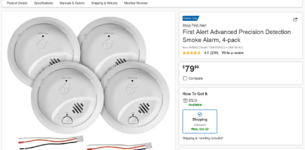

These are very reliable and highly tested and qualified products, so just get a well known brand at the best price you can find.
I got a four-pack of First Alert detectors like these from Costco; they replaced the original set that came with the home when new. And staying with the same brand assured that the mounting plate was already the correct size, and replacement was very easy.
You can download the instruction sheet from their website; that should tell you all you need to know.

I went to the product instruction sheet, and it provided a lot of information; however, it didn't specify the gauge wire to use. Can someone give me this information? It did refer to various fire codes; however, I haven't found any of them.
When I built my home over 40 years ago, the smoke alarms were hardwired to the Ademco alarm panel. If one went off, it would sound an alarm, and the alarm panel would dial the fire department for a response. After the second false alarm, with a full fire department response, I removed the hard-wired units and installed all battery-operated units. The burglar alarm was a lot less of a problem. When we added an addition, one of the wires was accidentally cut, disabling the entire system. It was abandoned at that point.
I believe that I still have at least 50% of the original wire left over in the cellar still on the spool. I think that it was 14-gauge stranded wire with a red jacket. Could that still be used if it has the correct amount of wires inside the jacket?

Note that these are only smoke detectors. Bedrooms and hallways should have combination smoke/CO detectors where applicable.
