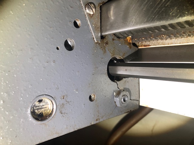

thanks for the input guys,
I sold my myford, for a bigger and heavier lathe.
I went to check the colchester today, took a trailer with me.
lathe looks really good almost as new, no wear, hardly used.
Looked very promising, until i saw this:
a hole and crack in the apron , so i thanked the seller for his time, and headed back home ....

That´s bad luck, Old Air, you´re far from blind! Look for another one, there happen to be lots for sale, although prices are risen for three-phase occasions since there are frequency inverters to run these 400/415V machines on 230/240V single phase. Good luck to find another one!

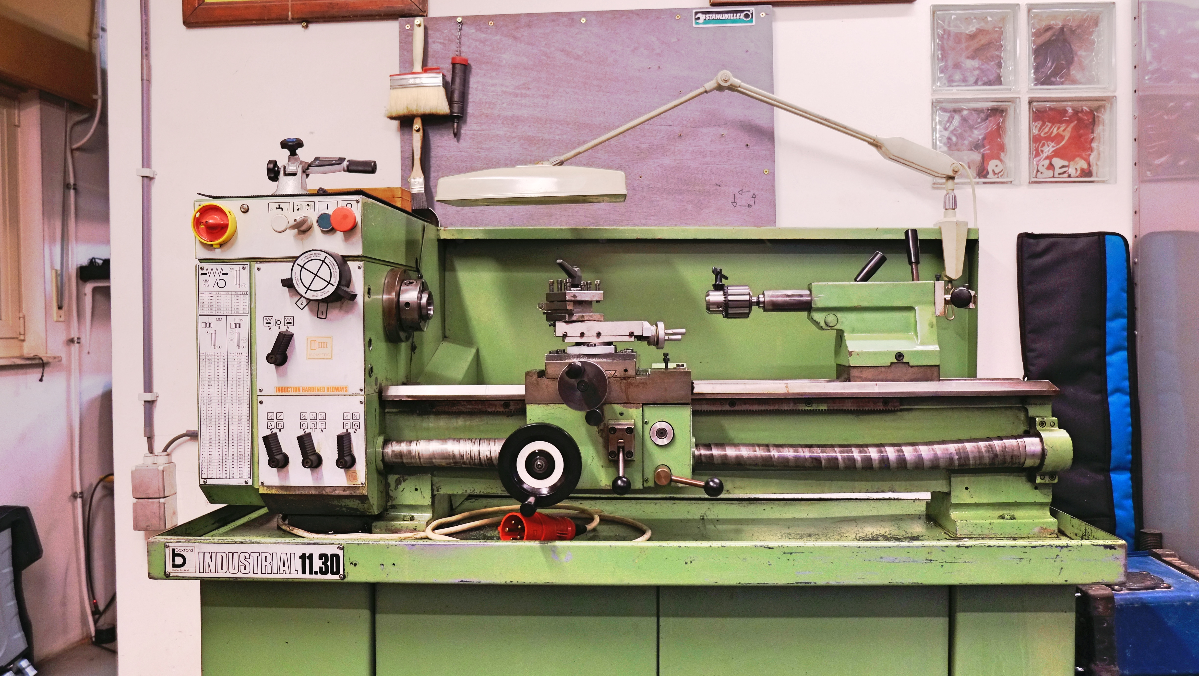

Last week i went to see the boxford, and altough cosmetically it looked like sh* , i checked everything with my dial indicator, and everything was perfect.
I was allowed to make some cuts, and check all the gears etc.
It was only used to machine some small precise parts, so didn't had a hard life.
it also came with a quick change collet closer and 10 schaublin collets.
after some cleaning:
