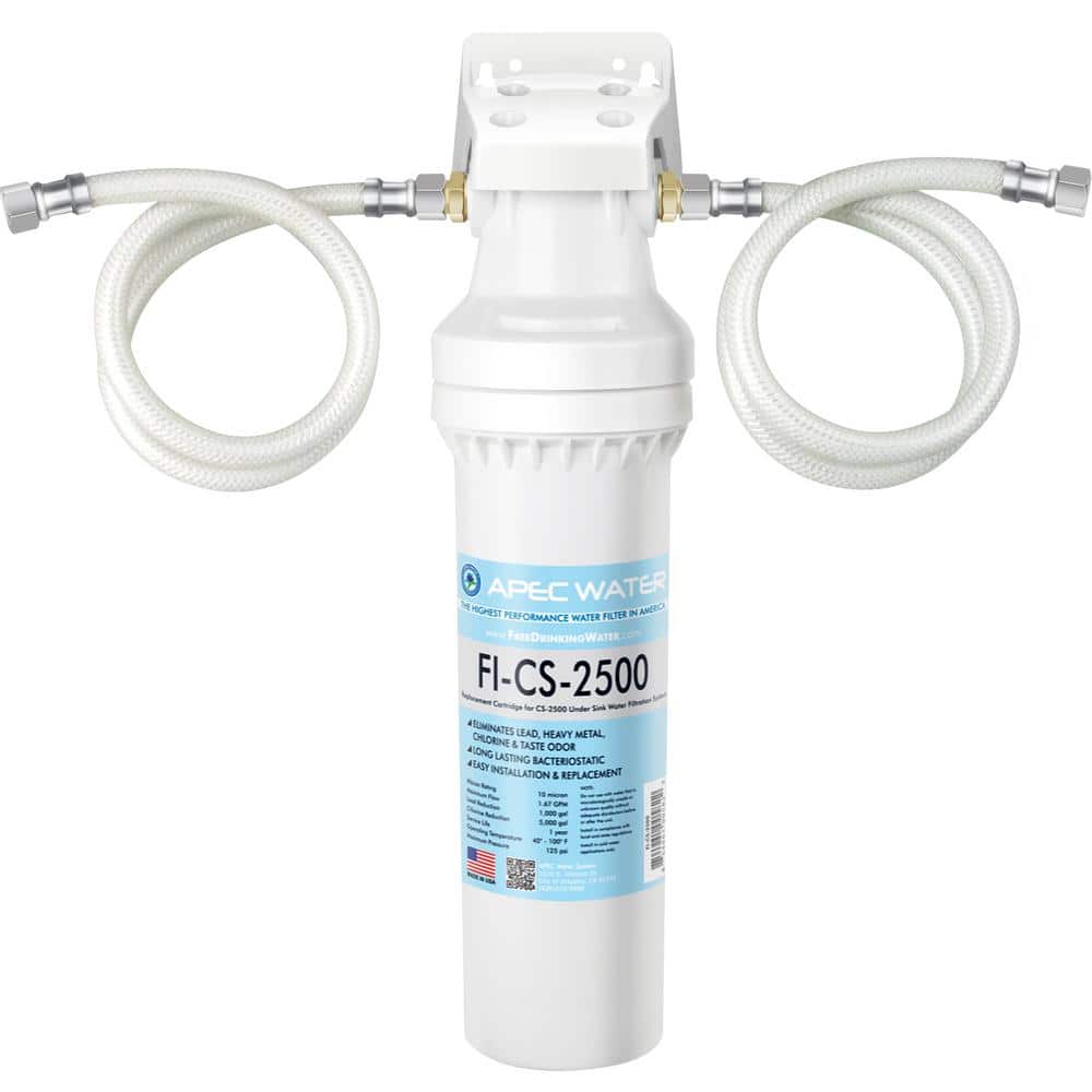

I use this rig under my sink...completely kills the chlorine. I've thought about doing one on the freezer for ice, but haven't gotten to it yet
APEC Water Systems CS-Series Easy Install High Capacity Under-Counter Water Filtration System
SKU# 206468676
