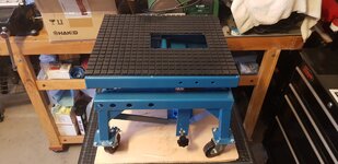

Did anyone bleed there cart per the instructions before use?
I followed the instructions on my new cart (model 60438) and it caused me to overfill the hydraulic ram to the point where it wouldn’t go back down without any weight on it. I pushed the table down while holding the lever and the plug shot out with hydraulic oil shooting everywhere.
I know this is an old thread, but I've owned one of these hydraulic tables (same model with the rubber plug) for years and use it frequently, warts and all.
But, after years of keeping a variety of lengths of sticks to place in the track to lower the table to various specific points, to prevent it from leaking all the way down (which it has done since brand new), I decided to attempt to "fix" the problem today. I followed the instructions in the manual, just as Jacobm99 did, assuming it just needed to be bled and perhaps it needed more oil.
Unfortunately, I experienced the same failure described by Jacobm99 in the quote. The table refused to lower past approx half-way. I leaned on the table and it blew the plug spraying oil everywhere. Thankfully I was wearing a face mask.
Now I'm left wondering if this table is salvageable back to previous dis-function, or if it is a big boat anchor. I don't want to risk the plug blowing out again. Wondering if a "rubber patch" and a hose clamp will hold as well as the plug?
Can anyone advise of the specific problem with this table and its' hydraulics along with a comprehensive fix? Or I can live with my bag of various length sticks if I don't have to clean up hydraulic oil messes again.

I found another Youtube video describing a fix for these lift tables that seemed to "ring true" for me (link below). He claims the bleeding procedure in the manual is dead wrong.
I tried his procedure except for adding any more oil. And it seemed to work so far. It didn't leak down over night. So... maybe.
When measuring for table leak-down with a tape measure the next day I noticed a couple small puddles of oil on the floor, hoping it's just residual oil dripping off the underside of the table after the rubber plug explosion extravaganza (twice).
I'm afraid it might be leaking somewhere else as a result of the oil I added per the procedure in the manual a couple days ago, and when that oil leaks out the table will go back to needing sticks jammed into the track to prevent table leak down. Which I can live with if it will always pump up far enough to jam the sticks in the track.
The rubber plug was very difficult to get back into the hole, so I used a hose clamp and "rubber patch" (see pic below). It's got to work at least as well as the damn rubber plug.
