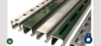

I want to make a tall, narrow rack system for my garage. It will fit between the two garage doors. It will be about 7' tall, 24" wide, 20" deep. With 4 shelves. I will be using 4 legs, as the top shelf needs to hold 250 lbs of rotary phase converter. The legs will sit on the concrete to bear the vertical load and the legs against the wall will be lag screwed to studs in the wall.
My conundrum - how to join the four pieces of unistrut that will form each shelf. I get using the 90deg brackets for the struts that meets on the side with the holes/open side. But how to join the other piece 90deg to that? It will be landing with an open end again the sides of the Unistrut with no holes.
What am I missing- is there a bracket that form that 90deg joint?
Of course, I want it as cheap as possible and strong.....

Two solutions I use for that: Weld or drill.
But I usually get the Unistrut w/slots and holes in the backside. Makes life easier.

The A2223 brackets are going to be the ones that you want to use to tie everything together properly. How ever you have to finds some one that carries them and they are 22 dollars a piece and you need 4 per shelf. Not cheap.
Are you stuck on unistrut?
Some clear 2x4 and ACX ply with these brackets makes a pretty quick, cheap, and solid shelving unit. Decent screws are included. Just make sure you screw the ply shelf top to the 2x4.
You can make them even cheaper if you mortice and tennon the 2x4's together which I did, but my neighbor did all his with these kits and its just as stable, stiff, and strong. And it will be stiffer than a comparable unistrut shelf

Get the kind on the left, and bolt together. Don’t think you need to support the shelves on all sides for such a short span.
I will look around to see if that is available locally. If so, then it solves that problem.
I am using strut on 4 sides as I will storing lathe chucks and stuff like that on the lower shelves. My OCD to have all 4 sides of the shelves supported.
