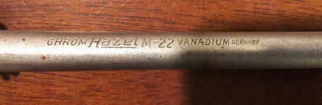

Strangely enough I'm struggling to find anything on this 3/8" square drive extended hex tool. When googling Hazet M-22, I keep getting M22 as a suffix for cutters that they make. Anyone know the purpose of this item? I would presume that the use is fairly specific.....

^^ You might try looking up Hazet-No 2722.
A catalog search lists it as being a Daimler-Benz (=Mercedes-Benz) special wrench for 6mm hollow hex head screws.
An internet search inputting 'Hazet 2722' shows some for sale being described as a 'shock absorber releasing tool'

Alot of german cars use female hex fasteners. That tool would be quite useful for many applications.

Does that joint in the middle flex?
OTG, It gives about 45 Degrees, and is a "ball swivel" and the actual business end (hex) is more a classic U-joint, and offers almost 80 Degrees as shown....

I realize this is old but the Hazet 2722 is an oil pan nut wrench for older mercedes. I have the 1962 Hazet catalog and collect hazet. 2722-1 is some late model shock wrench
