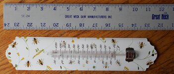

I have a 24-inch GREAT NECK. Aluminum. Stout enough to stay straight if it's not dropped from too high up.
Not sure this is what you're looking for.
Great Neck rules (Mayes)

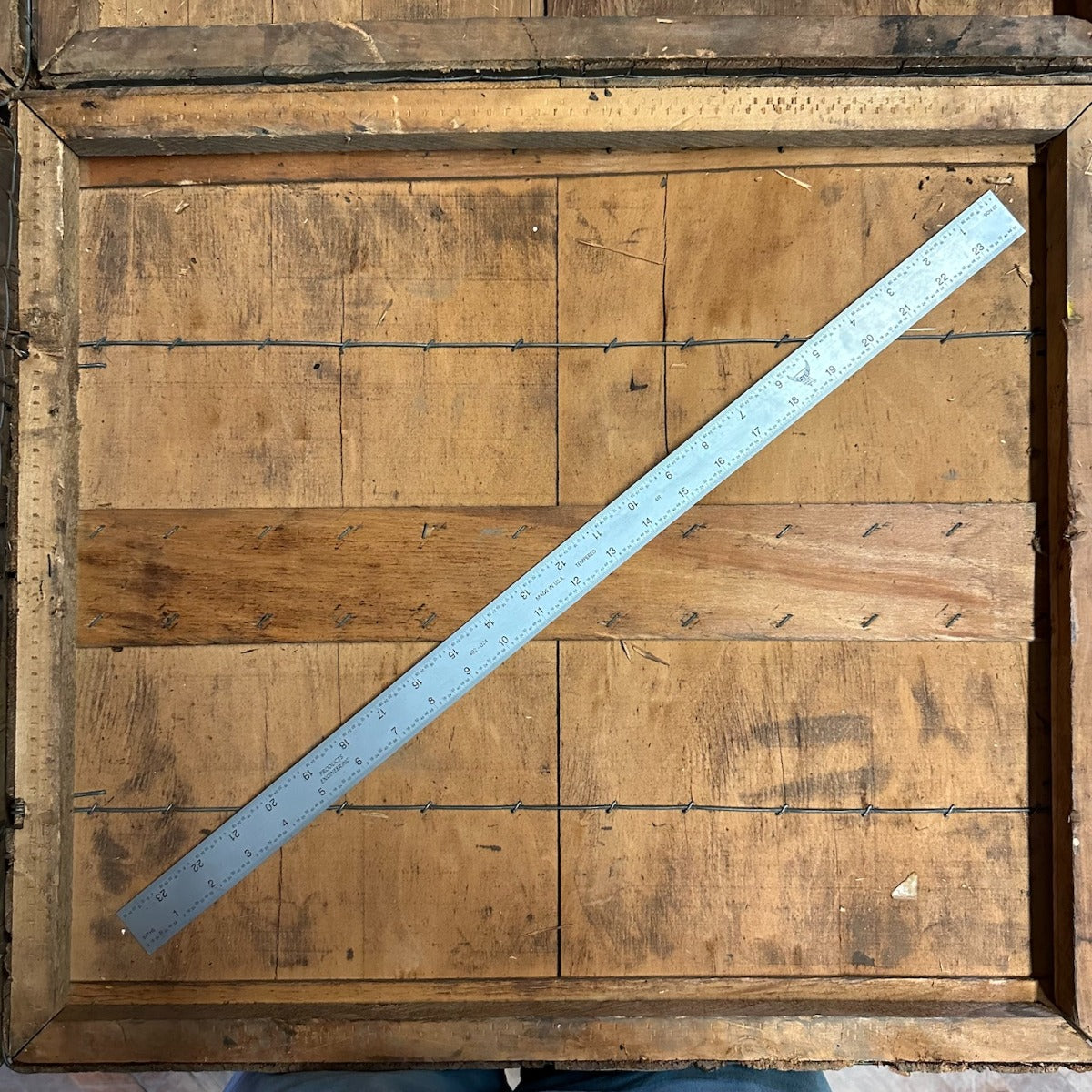

I'm not sure if they still make it, but my 24" Starrett came from McMaster years ago and is tempered steel with cm on one side and inch on the other, and painted engravings - and it seeme invincible. Pretty much the only thing I use for carpentry is a tape, that Starrett, and the little magnetic Milwaukee speedsquare, which also is pretty tough
