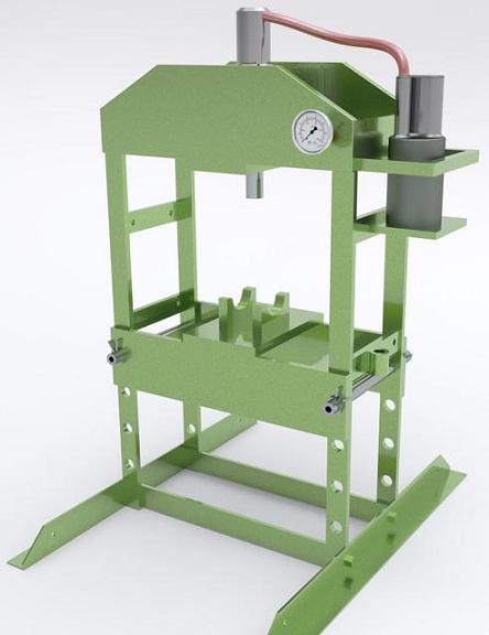

Using pipe complicates building the crown and the table.
Yeah using the pipe for the crown & table would complicate things!
I probably should have stated that the pipe would only be used for the up-right sections, And flat stock would be used for the crown and the table.
My original idea was to built something like this press;
Using the pipe in-place of the flat stock up-rights.
Doug
cvairwerks
Aug 12, 2016
7,320
Within hearing distance of Texas Motor Speedway
I understood what you were intending to start with. Mating the crown and a table, along with table adjustment capability to a cylindrical upright is much more difficult than with a flat surfaced upright. Here's a bench top one. Should give you an idea about the added complexity.

It can all be double-shear pinned joints if the press is centrically loaded, but its likely that eventually it will be loaded off center and so some welding should be considered...
I'm planing to use 3/4" rods as shear pins on the crown section along with welding of the joints.
There is always the solution of turning or sourcing slip-fit tubes for connections but again it adds to the time and complexity involved.
I've thought about that & I managed to locate some tubing that would work, But the extra time & cost probably wouldn't really add any strength.

Have you considered how difficult drilling the pipe for the pins and fasteners will be? It's not easy to hold long round's in alignment even on a mill You will be drilling twice as many holes then if you used flat bar or c channel. You will be working really hard to save not much money.

Actually, between the table and the crown they are loaded in tension...
Only if they're pinned, not bolted, to the crossbar at the top.
Bolted joints turn the upper crossbar's load into a bending load into the column.
Yeah I've thought about the alignment issues & I figure on making a fixture/jig that will allow me to keep the pipe square & index the next hole. I have an older 17" Delta drill press that is located next to a workbench so I can use the bench to hold the fixture/jig & pipe.
