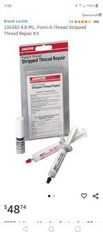

This was used on a piece of test equipment that was on loan to one of the facilities I managed. The equipment was expensive, but, more importantly, the equipment was needed at another plant ASAP.
For a low torque situation, it worked well.
That being said, I would pull the gearbox.
