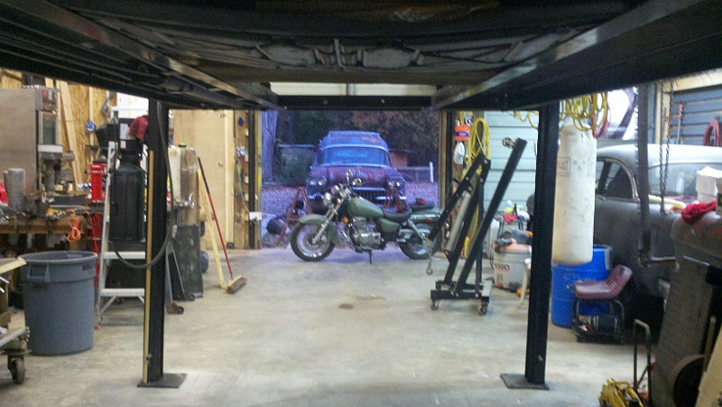

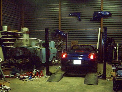

I've been lurking for a while, joined recently so I could see some of the pictures and figured it was rude not to share some of my own. My shop started out as a 30x40 pole building with 17' walls. I bought the place where I live primarily because of it and have since managed a few updates. When I first moved in there was a single 220 outlet, no loft, lift or lights. I purchased a four post lift about a month after I moved in but it was nearly seven before I installed some real lights:
from the front
from the back

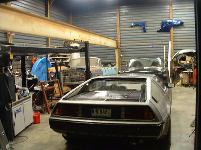

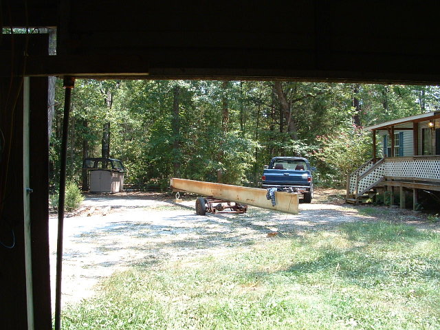

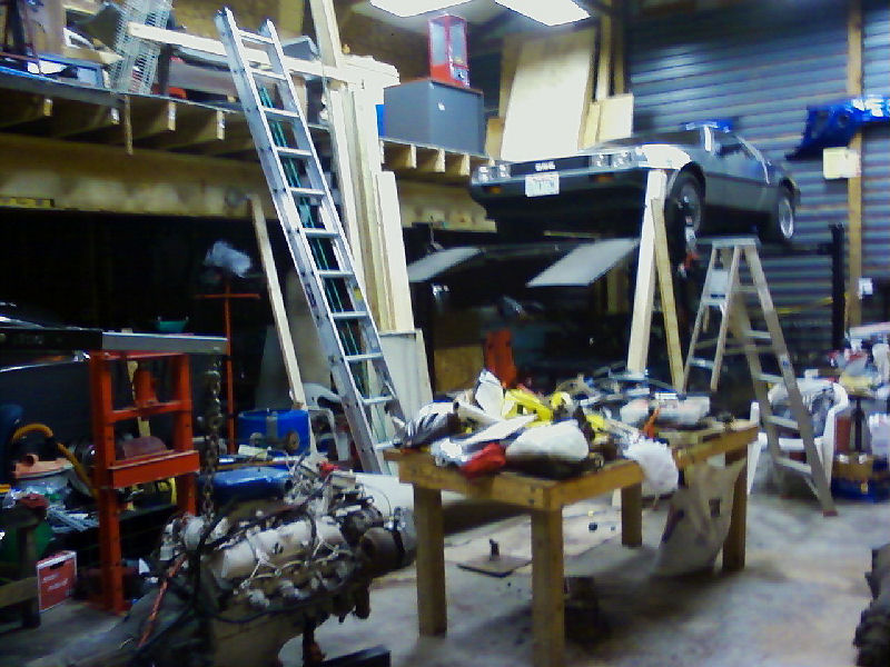

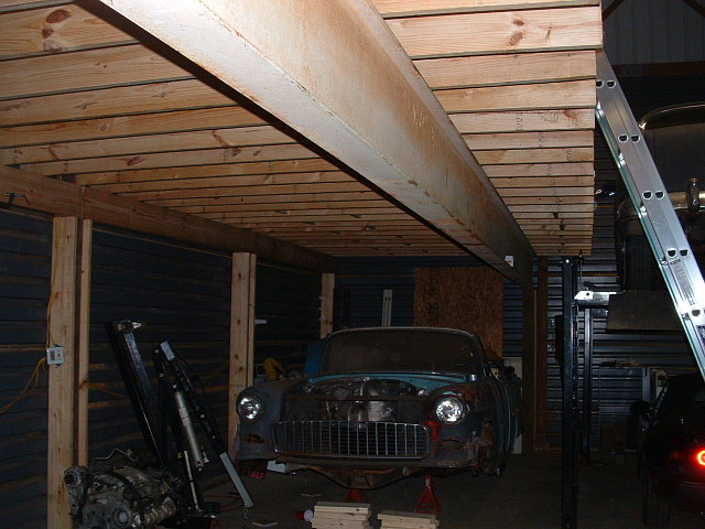

Two years ago, I put in a 40' 18w40 ibeam and began work on my loft:

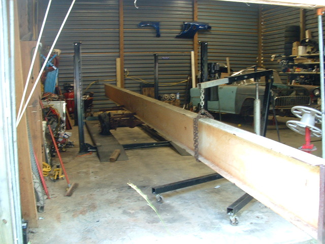

forgive the shakiness on this one - but I just wanted to show how I hung the beam by myself with the lift

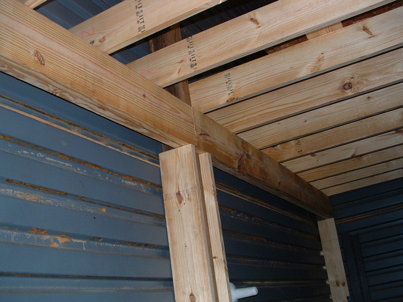

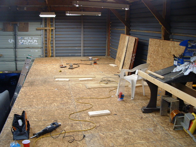

Last year I finally got off my **** and ordered the lumber I needed to do the upstairs. To which, it took me right at four hours to hang that I beam without any assistance at all. The first 2x10 I had to hang on the wall for the loft took me over an hour to accomplish exactly nothing and I had to call my father...who reminded me that I could simply put a nail in place to hold up the one side while I nail the other.
Dad came out and helped me one Saturday and we were able to complete the entire floor in about half the amount of time it took me to hang four 2x10's, six 2x8's and stack the rest of the lumber on those six joists.

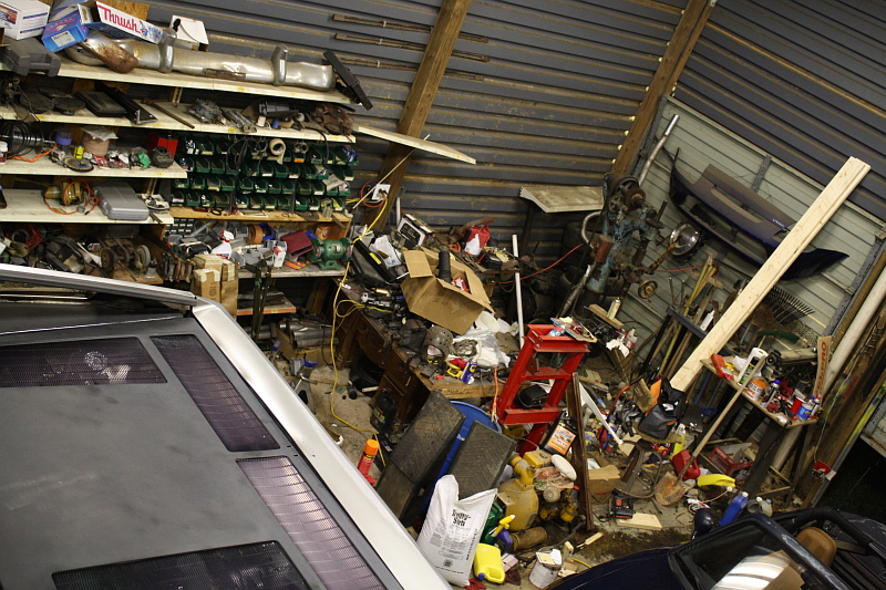

I took a few pics from above to illustrate my need for the loft;
started shuffling stuff upstairs pretty quickly but only so I could begin putting in some insulation and osb sheathing downstairs

Ingenious way to lift that "I" beam. Did you have to disassemble the lift to get it out from under the beam once it was set in place?
Nah, I took my cherry picker and picked the beam up about 6" on one end to clear the two lift supports so I could just roll it back to the center bay where it normally sits.

Nice big place, and nice DeLorean! Love the license plate. Holy un-organization batman! But I'm sure you'll get it all fixed up now that you have a loft to help with some of that. Keep up the good work!

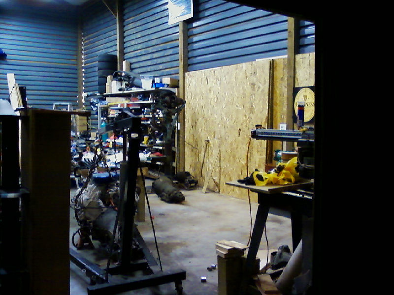

This evening was a pretty good step in organizing the shop. I put in two more sections of interior wall (OSB) which will allow me to put up my bolt/screw organizers and should also give me a little more room to deal with the engines that seem to follow me home.

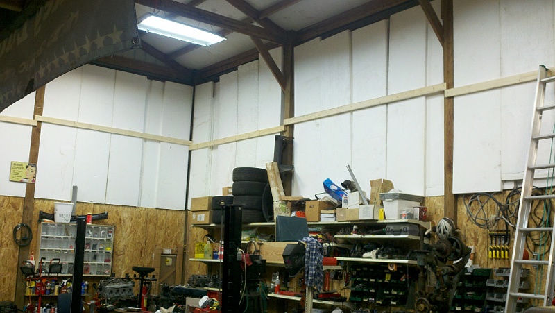

Some progress today - basically I've been knocking out the interior walls a 10'x8' section at a time so long as money and free time allow. Last week I got the two sections of the back right corner (looking into the shop) done and today I did the center section at the back. When I'm finished, I will have R12.5-R13 in every wall except for the upstairs south facing wall which has R25 in it. This is all covered with OSB sheathing so I don't have to fret about hanging stuff.
I grabbed these pictures before I put everything back where it went and filled the thing up again.
and a shot looking from the back to the doors

So my father and I needed some insulation. I needed it because in spit of the large stack of 2" foam you see in the pictures above, it wasn't enough to handle all of the walls and the doors. My father found a guy on craigslist that was selling 2x8 sheets of 2" styrofoam. I needed 75-80 to complete my project and he needed about 300 for something he's working on. Well, we brought back 400 sheets on two trailers to my house with the expectation that he would come get his within the next several weeks.
Neither of us are very good at predicting the future.
So I had 400 sheets of styrofoam that I decided to store in the shop so it is out of the yard and went ahead installing the 80 sheets that I had bought for myself. While doing that I had an idea on storing the rest to an extent that it would at least be useful while it was here:
So far, I've got 25 sheets installed in the last five sections of wall that I did and another 24 sheets in the two sections of wall above. I've got five more upper wall sections that I can do which will allow me to store 109 sheets total without making any extra clutter in my way and before forcing me to put extra supports in the rafters to stack the rest.
This also helps on heating and cooling details so if the stuff ends up being there forever it won't be the worst thing that could happen.

Nice. Nothing like insulation to get everything right. And your not kidding, it is pretty darn full up there, lol!
