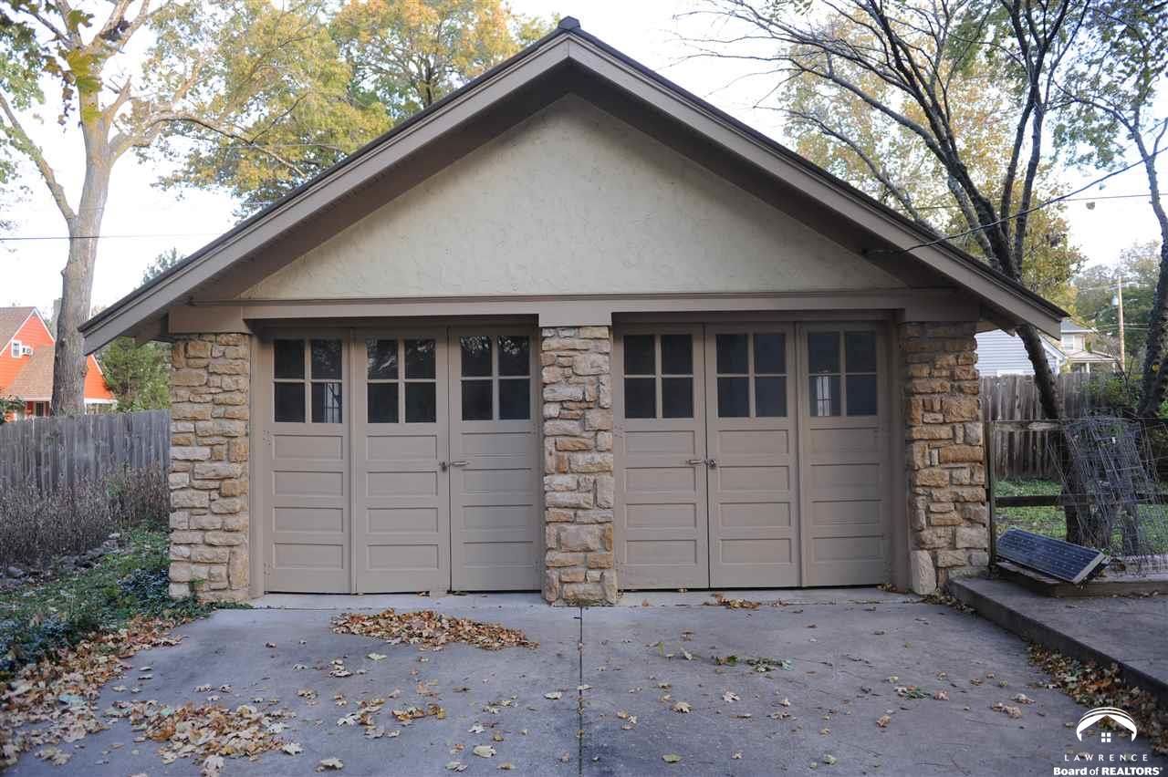

So after many years of moving around and having only tiny 1-car garages - here, here, and here (that last one being bigger but wooden floor couldn't support a car) - my wife and I finally started looking at buying a house.
And she agreed that I need a 2+ car garage!! :bowdown:
The first house we both fell in love with had a very handsome, detached 2 car garage. I was already making plans for bumping it out, adding a lean-to, etc. And we put an offer on it! Sadly, another offer was accepted while we were negotiating the closing date with the seller. That was yesterday.

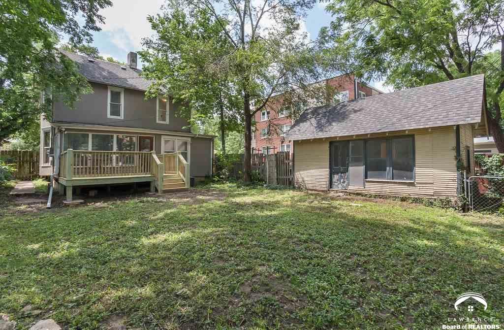

However we had a very close runner up in mind, a better house at a much lower price, but there's no garage. I mean, they call it a garage but I call it a shed. It measures 10' x 16' and has a large crack in the concrete slab.
Here it is:

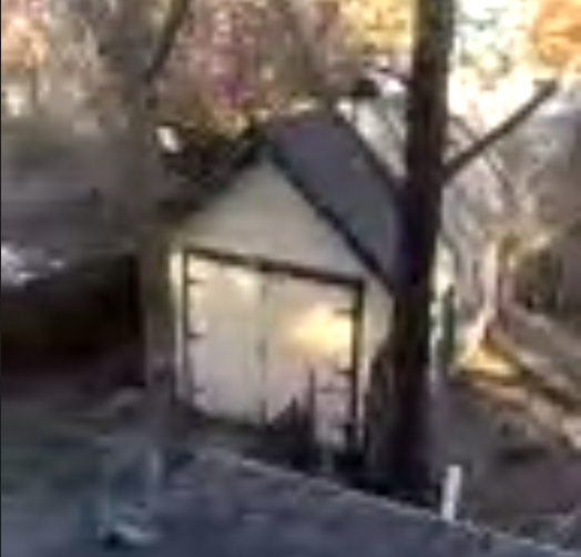

Here's another picture but I feel I must apologize for the quality - our buyer's agent was doing a FaceTime tour for us as we're currently living 1,800 miles away, the video quality was terrible. No picture from the listing either. (why do home listings never have pics of the garage??)

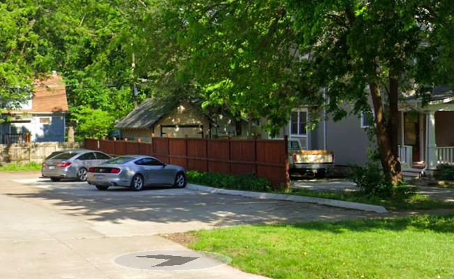

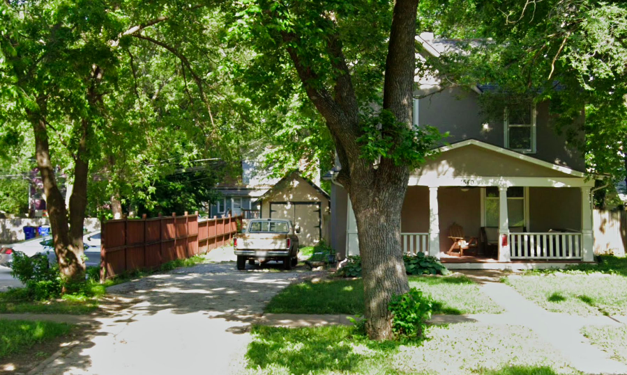

And a few photos from google street view:
So you can see there is a larger tree to the right of the garage door, a smaller tree in front and a little off to the right, and not much room to the left (more on that in a minutes). Also, note the two windows above the old Ford pickup. Those are the windows above the kitchen sink, so we do not want to block those!

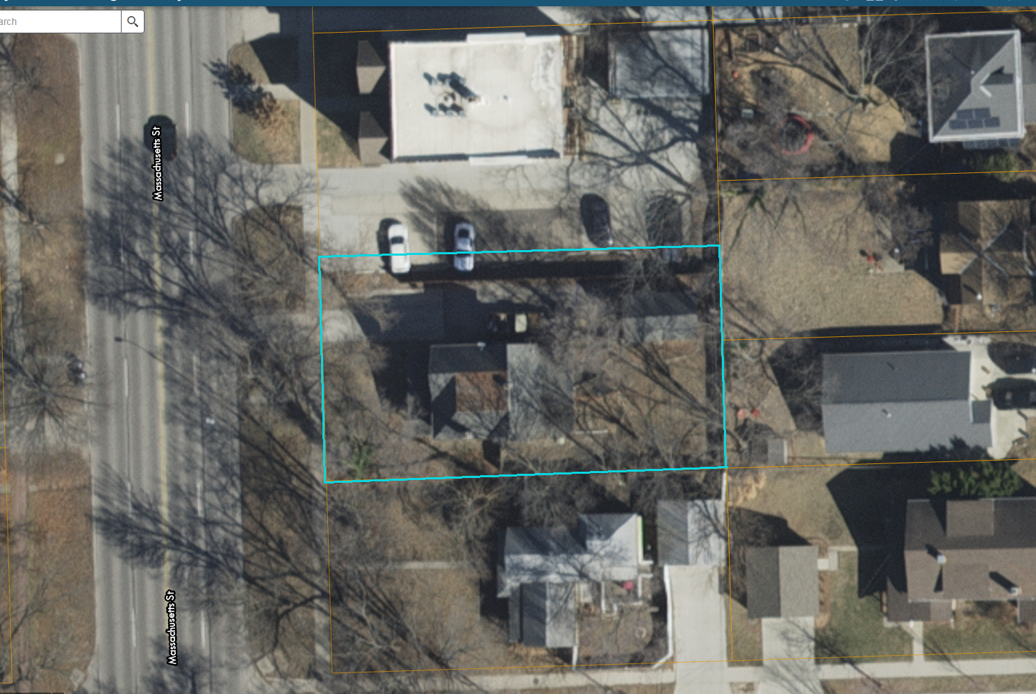

And now for the all important GIS satellite image:
Does it look like the apartment to the North has their parking over the property line?! I doubt the line in mapping software is totally accurate but all other lines look like they're where the should be, i.e. on fence lines and sidewalks.
So I would need a survey for sure. I think the apartment was build in the 80s or 90s so I would want to look into "adverse possession" laws.
But if it's true that there's more space to the left of the garage door then I should be able to fit a double-wide garage door in there no problem. Right?

you could get a survey pre purchase , or in your offer ask for a survey as a condition, and if the lines are where they appear now, you will buy the house sort of thing .
the rest, well I would get a hold of the municipality or town or whatever and ask most of those questions .

All trees need to go. Too small of an area to use machines and save trees.
If possible give border ten feet. Building and trying to paint that close on a tall wall is hard.
Those gis maps are not right most of the time. You definitely should plan on getting a survey esp with such small lot.

I got a survey with my property purchase however I got another one when I was planning my shop. This time I had them stake the property line every 10’ or so down one side where shop was going.
