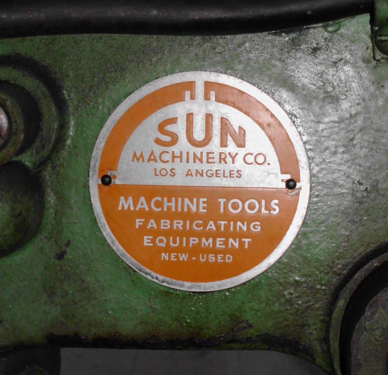

So what is the final word? Does the vintage / style matter? I have read a number of threads with different suggestions and different results. Ordinarily I would have attacked this with Simple Green (thanks Outlaw) but I also read that Simple Green may damage the Walker-Turner badges. This one is already in pretty rough shape. As I understand it, it came out of an auto supply that also did some repair work. Still, I have no idea how the machine got so thoroughly covered in oil and grime.

I would start with WD-40 and a toothbrush.
Some might say 0000 steel wool if the grime is caked on there.
Remember, be gentle!
39,283
for grime, WD-40 with the tooth brush is a good start point. That may be all you need.
I'm not a fan of steel wool or other abrasives on badges, except maybe rubbing compound.

Ok two votes for WD-40. (Tooth brush, no steel wool.)
Thanks.
Worked pretty good but as I suspected there wasn't much left to save. It has a very 'beach cottage' look to it. Vintage denim.
I wiped it down with Windex afterward and even that took blue paint with it. I suspect it must have sat outdoors for a while.
The dealer tag was a pleasant surprise though. It looked so flaky I didn't think it had a chance. Instead, all the paint from the last 'restoration' came off clean and it looks great. Maybe a little more scrubbing.
I'm thinking a little polish for the dealer tag, but what about the main badge? How do I protect it while working on the surrounding surfaces? I wonder about spraying it with clear satin polyurethane to stabilize what's left. I worry it won't stick and will make the situation worse. Thoughts?
