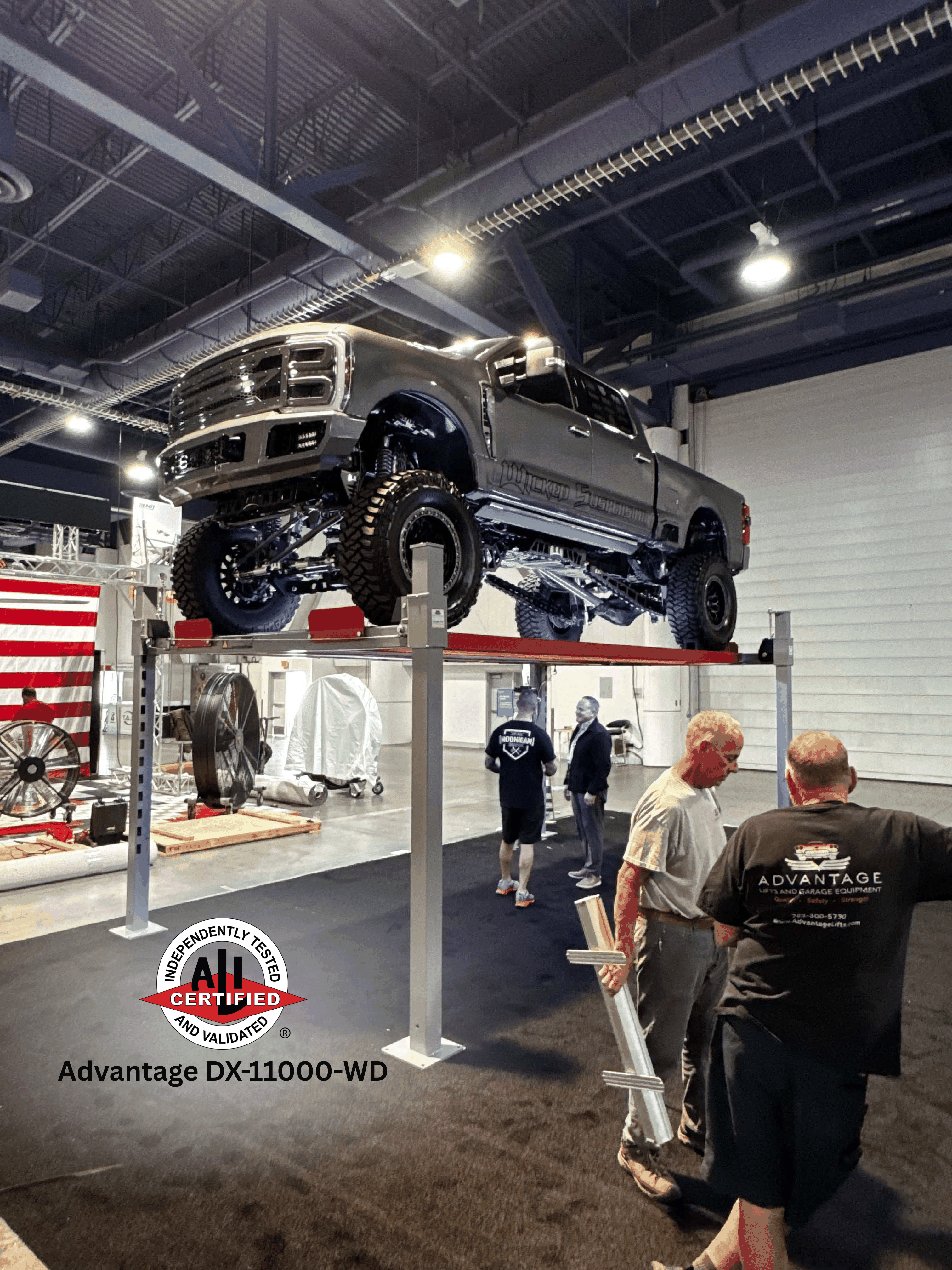

Take a look at the Advantage DX-11000, with bridge jacks. Expensive, but no excavation/water worries. I find the four posts to be a complete non-issue when parking under the raised lift, because you’re not going to hit a post without first hitting the garage door opening when driving in, and there’s nothing obstructing opening a car door like with a two post lift.

I find the four posts to be a complete non-issue when parking under the raised lift, because you’re not going to hit a post without first hitting the garage door opening when driving it, and there’s nothing obstructing opening a car door like with a two post lift.
Agreed. I park under one daily. It's a total non-issue.
