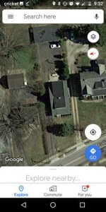

Here's your property. Not the best picture but best I can do.
On the left rear corner or your garage, install a sump pit and french drain around the garage so it makes its way to the pit.
Then run the discharge line on the left side of your driveway until the very bottom, right before it hits the sidewalk, and install a pop-up discharge. If you want to make it even better, you can remove the grass around the pop-up and surround it was some rock to not make a mud pit.
This will absolutely alleviate a great deal of your standing water issues. Since you'll be pumping the water away from your back yard.
You could also dig and install the pit on the left front corner of the garage and send the water from there. And I'm talking about installing the discharge pipe right next to your driveway. I doubt the neighbor's property line is right on your driveway.

Can only see 2 overhead pics in post #5, no others are showing for me.
Anyone else having this issue? I'm hosting them on imgur. They show up for me.

Pics working now?
Not the additional ones added later, at least for me. Google and video enough though.

Can finally see the pictures - is your garage and back yard higher than the street? Now that I can see them, looks like you may not need a pump, you should be able to trench to street.
Also what does your front downspout drain into? If it drains into a storm sewer or out to the street, that should work for you. Also check local codes to see what's possible before you draw (or attempt to) draw a permit.
In my case, my town does allow connections to the storm sewers for storm runoff so I can get the permit and do it.
