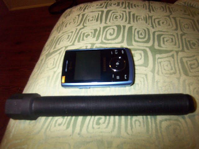

I ended up buying a puller (have not used it yet) but seriously considered making my own at one point. The forcing screw on the one I bought is freaking massive. Probably over an inch in diameter.
I was planning on using a threaded bung used for making rock crawler suspension links. Then just finding a properly sized bolt. At the time I had the machine shop capabilites to make the "disc" that grabs the lugs. Something like this:
