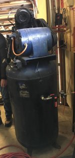

I found this Champion compressor today locally and left a small deposit to hold it. The compressor ran a DA sander, die grinder, and ratchet great. Cycled fine and ran quiet and smooth. The only issue is the flywheel seems to be bent, installed on the shaft crooked, or the shaft itself is bent. He stated it has been this way since he bought it and hasn't had an issue.
From what i can tell the pump is a R15 with a GE continuous rated motor with a magnetic starter. The previous owner removed the inspection plugs, pressure washed the tank, then sprayed the inside with Rustolem rust stop. I couldn't see any oil leaks from the pump.
Anything I should look out for when i go to pick it up?
Pics and video to follow.

The pump is either a R10 or R15. We would need bore measurements or at least a ruler from the block to the top of the fins to identify it one way or another. The motor is a 3HP which is a configuration Champion no longer sells with a R15 pump. The air filter looks wonky, but is present. Champion has long painted everything green so this is a replacement pump. The Tri-Clad motor should last forever as they are some of the best ever made. The wiring looks questionable. I wouldn't pay more than $500 delivered.

Isn't it cool how old iron just keeps on working? Looks pretty low rpm. Cast iron does not bend. It breaks. It would take a lot to bend an 1.125 inch medium carbon steel shaft that is only 4 inches long.
I bought one once like that. It was missing the keystock. It was hard to get off but an easy fix. The "bent shaft" and extension cord wiring should be good negotiating points. The tank condition is the big scary question mark.

Compressor is installed and wired. I removed the flywheel and used a dial indicator on the shaft. It is bent about 60 thousandths. Must have taken a hard fall in the past. I placed the flywheel on a truing stand and it was perfect.
I did the math and the compressor is putting out 9.8 CFM. Not to shabby for a 67.
The wiring has been updated, Sanborn filter installed, but I cant for the life of me find the correct cover for the magnetic starter. I've decided to 3d print one.
Thanks again for all of the help. If anyone has a nice straight R15 crank laying around I would be interested.
