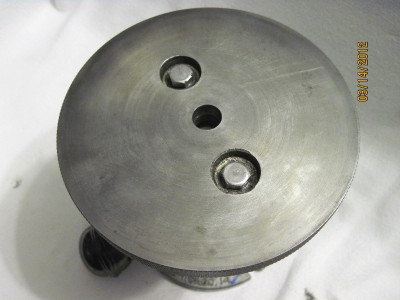

Help identify this "pin" vise

I saw this on eBay and wondered who made it. I know the base is a Wilton pow-r-arm, but I don't see any markings on the vise part. Any ideas?

How do you even use that thing as a vice? Seems limited in its travel and not very strong...

They're called Engraver's Blocks, used by engravers to hold the workpiece for, well engraving of course. I believe watchmakers sometimes also use them. They're not cheap.
I have a cheap made in India pin vise that's similar to an engraver's block except it's smaller & made of aluminum. It originally had a removable handle with a square base for mounting in a vise. I machined the bottom flat to sit on my bench without wobbling. Got it from MicroMark, they call it a universal vise. HF sells their version too now. I use it for soldering PCBs & LEDs when building flashlights.
