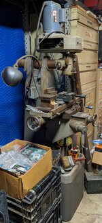

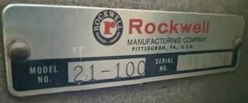

Victim #2: A Rockwell 21-100 Vertical Mill
and

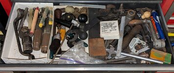

And here are the drawers full of accessories. It's not everything. I'm pretty sure there is a crate full of gears and turning stock on one of the shelves. Haven't dug that far into the garage just yet. Still clearing a path in that direction.
Slowboat
Nov 5, 2010
609
Green Mountains
I had the same mill and same shaper, so hopefully I can help.
Picture 6, lower left looks like an internal keyway shaper tool, and in the same box a handle that might fit the vise or shaper. There could/should be two of them. That whole box could be to the shaper.
Some of the Armstrong tool holders could be for the shaper - need more detailed pictures.
I don’t think so, but picture 5 has a long shot of being the indexing center.
I appreciate your taking the time.
The fruitcake box. The second of those handles is sticking out of the top of the machine.
Will tear into all of that again tomorrow afternoon and get photos of all of the tool holders then.
The item marked 10-326B / 10-326T ? The other large item in that photo, from what I understand, is the bottom view of the rotary table for the mill.

I agree with the fruitcake box. One looks to have a long bar and a holder for internal keyways, as the other has a holder for cutting bits.
Not the 10-326B item, but below that. The thing you listed is a steady rest for the lathe.

My guess is the handle on the right with the S/Z shape (third in from right) will fit the shaper.
The shaper still has both of its original handles accounted for. Unless the shaper requires a third of a different size.
Do the top two flat faced things thread on the lathe? They are faceplates, where work is attached (either directly, or using "work dogs"). Same with the 3 and 4 jaw chucks, would probably be for the lathe unless you have a rotary indexer.
Not sure. The lathe is still pretty deeply buried. That's part of the reason I'm working to get the shaper and all of its accessories bundled and sold. Would love to go through and play with the lathe. The garage needs a new paintjob.
It is harder for me to get text in between photos on mobile when there isn't text in between pics, sorry. These are my best guesses.
I'll make edits. Some of the descriptions you posted don't seem to correspond with the items in the photos cited. Could just be down to a formatting snafu on my part. Give me five minutes to add in some text.

So far, the only pieces I am seeing that are definately shaper-only are the small items initially identified in the "fruit-cake" box. The black bar with a nut at the end (shown underneath the grip part of the handle) and the silver bar with an O shape just south of it, unless some of the square wrenches fit specific spots you see on the shaper. Does the handle fit on the shaper vise by chance?
Otherwise, the tool-holders (bottom four that take square inserts) could fit the shaper or the lathe, as well as if a boring bar or two fits in the "silver bar with O shape" in the fruit-cake box, it would be used for internal keyways. Not saying you couldn't also use them in your lathe if you desired, just depends on how "complete" you want to sell the shaper as. Same with the HSS blanks in your first post (bars shown in your first post, one pic below this linked one).
All of the square wrenches fit the square fasteners on the shaper. The handle and its identical twin fit all of the square nuts on the shaper, and fit the vise. It's all there.
I am swimming in HSS, cobalt, and carbide blanks. Also slotted razor blades, from the looks of things.
