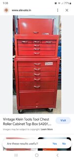

I agree it looks like it could be Waterloo or at least made by them and sold under different badge. Here's a klein that looks just like it. Wouldn't surprise me if it were Mac.

If you look at the rails on each side you will see it is not waterloo, but maybe duplex or some maker with that feature
I had a Snap-on box that I bought in early 1980s that was very similar to that box construction (the dividers in top, slides and the way the metal is formed at front) I thought Waterloo made those boxes but could be mistaken.

Those open square top rails were a feature commonly seen on duplex and amd boxes, but not waterloo

Here's a similar Mac but the gaps on either side of the front panel of yours are a closer match to the Klein above. Middle drawer is larger too but Mac had a bazillion drawer configs. That one you posted doesn't even look like its ever had tools in it!
