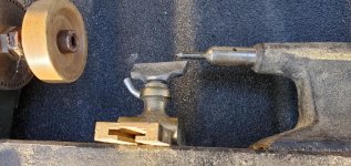

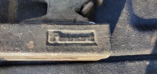

Picked this up the other day but can't figure out the brand or anything about it.
Any ideas? Looks like a bench mounted mini lathe. Thanks!!

That's a Pennant watchmaker's lathe.
Not terribly useful unless you're into model making, or other small work. You'd need at the very least a belt and a small external motor to make it work (the belt will have to be assembled around the spindle) and you'll need a selection of collets, a drawtube, gravers and other tools to make it useful.
