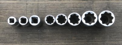

Help identifying socket.

For square-headed bolts, as hermetic notes, for things like brake adjusters. Not car-specific at all. In fact, not only for cars.
I have a set a bit newer than that socket which gets regular use around here.
2oolhound
Dec 18, 2010
5,918
BC Canada
It fits all the old square head bolts, nuts, lag bolts etc. (think farm machinery, old lathes etc.) The 8point allows you to position the handle at 45' instead of 90' that a 4 point would restrict you to. I keep a set on hand and run into square head fasteners fairly often.

Many differential covers and transmission fillers and drains used pipe thread plugs with square heads. 8 point sockets are not uncommon. Here are a couple of WW2 vintage D-I 8 point sockets.

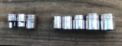

These pictures are all of the same socket so, to me,
:confused:, its a 1/2” some sort of star socket.
I'm sure everyone realized it was the same socket. Square drive with a star, 8 point, or double square service opening. Same as a 4 point or square socket. Only 4 of the points are engaged with a fastener (as others have said, drain plugs, or any square head bolt, etc) at one time. As 2oolhound explained, you can slip the grip a quarter turn.

They first made them 4 point (single square). It was later changed to 8 point (double square) much like you have 6 point and 12 point sockets.

Others have addressed the use. I believe I remember seeing here that the vertical lines around the socket in the OP's photo ID the maker as New Britain. Please feel free to correct me if I am wrong.

Hard to see, but take a close look at the last photo, you can see that it is Snap On, these just weren't deeply stamped back then.
