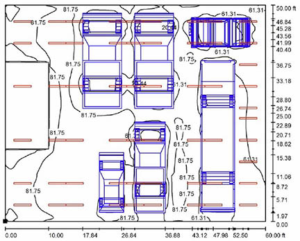

Platonic Solid
Nov 29, 2014
3,587
CT-USA
50x60x18
Cooper Metalux 8TSSF-254-UNV-EBT1 Qty. 18
Cooper Metalux SSF-254-UNV-EBT1 Qty. 18
Spec Sheet: http://www.cooperindustries.com/con...ts/metalux/spec_sheets/081872_SSF114_SSSx.pdf
Many manufacturers make similar style strip lights. I do not recommend any fixtures with lamps right next to each other. Assume that you'll probably have to special order these fixtures from a local distributor. I do not recommend the Metalux SNF series or the Lithonia Z series due to poor lamp spacing = reduced efficiency.
F54T5HO Lamp Qty: 108
Suggested lamp: Sylvania 20906 or 20949
$3.80 ea. (the 25,000 hr. Life on that site is wrong. The spec sheet I linked to says 40-45,000 hrs.)
Your ceiling height works with either F32T8 or F54T5. Went with F54T5 to reduce fixture quantity, thus reducing total lighting purchase and installation costs.

50x60x18
I don't have any boats to insert as objects in the building, so I modified 2 pickup trucks
(wider and longer than normal trucks)
SSF-254-UNV-EBT1 is 46" long and 8TSSF-254-UNV-EBT1 is 92" long.

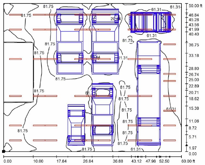

The Isoplot posted tells the whole story. Keep in mind that most of the fixtures are around 18 ft high and this layout is weighted towards a simplified purlin install. Eric (efinley) will have to chime in on whether he wants to run unistrut parallel to the vehicles, in which case the layout will be quite different. The layout shown is not how I would place the fixtures if I had a solid ceiling surface to work with, but 40fc between the 5th wheel and the wall is respectable.

Here's an isoplot with 4 more fixtures - 1 for each purlin at the camper/wall isle which takes it from 40fc to 61fc without the unistrut/fixture rotation hassle.
Fixture schedule would then be:
Cooper Metalux SSF-254-UNV-EBT1 Qty. 22
F54T5HO Lamp Qty: 116
