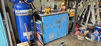

I have a large old electrical enclosure in my garage that serves as a work surface (mostly to support bench grinders) and storage. Photo is below - pardon the mess - I'm workin' on it!
To increase the storage space and utility of the enclosure, I plan to build two large drawers with heavy duty slides to mount inside it and hold:
Power Tools - top drawer
Jackstands/jack-related items - bottom drawer
The drawers will be as wide, deep and high (two equal height drawers), as the enclosure will allow. I plan on 3/4 plywood front, back and sides, and a 3/8 plywood bottom. I'm thinking I'll use pocket screws for the "box" and putting them on the sides so they are at least a little bit hidden. These will be crude drawers for garage storage. Looks aren't too important, but I want them to look "decent". I'll probably paint them grey.

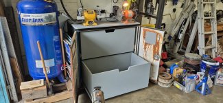

I thought I would update this post with "the rest of the story". I FINALLY got my drawers built and installed. I'm happy with how they turned out, but it was WAYYYY more work, time and expense than I first thought... as usual.
It started with a plan:

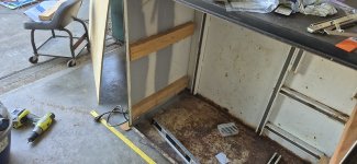

I added 2x4s inside the enclosure to put the mounting points into the opening and not blocked by the steel lip around the front. It took a LOT of shimming and trimming to get everything equal-width, plum, etc. :

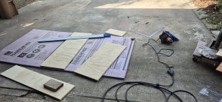

I cut down the parts from sheet using a Kreg AccuTrak saw guide and a 4' x 8' piece of hard foam insulation. I saw that online somewhere and it is a very good way to cut down sheets if you don't have a table saw etc. The fronts were cut from a left-over sheet of 3/4" marine plywood I had. The sides and back were cut from 3/4" (actually 23/32) Radiata plywood from Homey D's. The bottoms were cut from 1/2" (actually 15/32) ProWood BCX plywood. I would say the saw guide was worthwhile. I was getting accuracy within 1/16" or better for the most part. Not furniture grade, but better than I would have gotten by hand or by clamping a level for a guide:
I cut dados around the inside bottom of the panels. The bottoms were 15/32" thick, so I bought a 31/64" dia. router bit made for undersized plywood from Rockler. The clearance seemed about right to me as a non-woodworker. Maybe a hair loose if anything. I also added pocket screw holes to the sides with a Kreg Pocket Jointer:
I glued the drawers together and clamped with ratchet straps, and checked them with a framing square to get them as close as I could to square:
After the glue set I drove the Kreg screws. After the drawers were together, I decided to add a bottom stiffener. Then I painted them (one coat of Zinsser 123 Primer, and two coats of floor and patio paint (Valspar IIRC).
I installed the drawers into the cabinet. I ended up buying heavy-duty slides from Rockler as mentioned in the comments. They were 3/4" wide instead of the original 1/2" wide ones I had already bought, so the plan had to change accordingly. Then I decided to add a top to the enclosure, which had just been uncovered steel before:
Lastly, I cut thin luan to cover the various openings (also painted grey) and put the doors back on. I attached the new top to the back wall with angle brackets and screws so the whole thing wouldn't tip when I opened a heavy loaded drawer. I also added a draw-latch (from Amazon, stainless steel, surprisingly good quality) to keep the doors closed since I had to remove the original latching because it went too far into the enclosure:
I'm concerned the drawers might be "too" deep. I gotta get them loaded up and see how it goes.
Try measuring the diagonals instead of using a framing square. If diagonal measures are equal it’s square.
Glad to see you went with the heavier drawer slides. Dems some big drawers. Or perhaps draws as some folks call it. Although I have never seen draw slides advertised.
