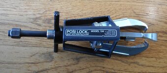

I have two drawers dedicated to pullers, with others scattered about. It really depends on what you work on. The Proto puller set is nice, and expensive. I can duplicate some of it, but I really only buy what I need. I would highly recommend the CG series of Blue Point pullers. A CG-270 can do almost everything your Proto set can do, and maybe more. From timing gears to ball joints, it is versatile and effective. The slide hammer can come in handy pulling axles, injectors, some transmission bearings. Clutch pilot bearings can use a smaller slide. Also, for body work, you might get a slide made especially for that, as the big bulky slides aren’t as easy to control. Bushing pullers, power steering and AC pulley pullers, blind bushing pullers; there are a lot of special ones. Battery terminal pullers, windshield wiper arm pullers, wheel pullers, universal joint pullers, pinion bearing pullers, cam bushing pullers, cylinder liner pullers, harmonic balancer pullers, steering wheel pullers; you can see that it is difficult to know what you might need. There are even pullers for pulling flathead heads, which can get stuck and be difficult, especially when there are studs instead of bolts. And some of these are specific to a particular year or a small range of years. Take the advice given above, buy what you need when you need it, and you will be money ahead and not have a lot invested in tools you may never use. You may even find that you can make an effective puller for much less than you would spend buying one.

Posi-Lock is worth looking at. Not sure what you're specific needs are.

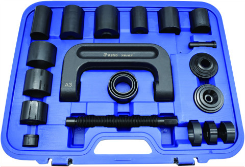

If you want to spend the money then my post won't help, but here goes:
I own this set. It provides you front hub, rear axle, rear axle bearing, pilot bushing/bearing, and one size of 2 and 3 jaw pullers.
This will do harmonic balancer/front pulley, and steering wheel.
Buy this and steal the legs and adapters to use on the Gearwrench 2 and 3 leg adapters.
I'd get a good power steering pulley puller/installer. Probably off ebay.
Pitman arm and tierod I'd get from Lisles if they are still USA made.
I can't help on body work.

I have an OTC slide hammer set, which I'd dare say is kind of the standard- it's probably identical to the Gearwrench above. It's a good starting point. Whatever larger size slide hammer you buy, make sure it has the standard 5/8-18 thread and not a 16 mm.
I have some Proto pullers, and they're definitely high quality. Same with Posi Lock. You might also look at OTC; pretty much all of their pullers and slide hammers are Taiwan, but they're excellent quality. Quality pullers, slide hammers, accessories are all very expensive. My first puller set was HF that I bought in the mid 1980s, and I still have them. These were all Taiwan made at that time, and quite good for the $; I used them all the time working on small engines.
If you don't really have a need, you might consider a basic three-piece three-jaw import set of reversible pullers to start with, along with the basic OTC, GW, etc slide hammer set.

If all you are going to do is cars get a front end service kit, 99% of the pullers you will ever use are in that kit. Occasionally a 3-4 inch 3 jaw is handy and one day you may want a slide hammer for pulling axles, bushings, and hubs.
Body work is a different kettle of fish, where you may use a slide hammer but typically with different attachments than those proto kits have.
As much as I love pullers other than my front end service kit I almost never use them on cars. Even at work where we have a cabinet full of pullers we still probably build new pullers for about every 4th job that needs one.
