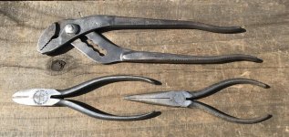

Took some cleaning to discover that these battery pliers are Utica 524-7. Anybody able to date them?

Bill,
My best guess is that they are from the ‘50s since the part number isn’t stamped into the tool. I had some adjustable wrenches with the three diamond logo and username alerted me that they weren’t wartime.

That said, I know we discussed linesman pliers at length, but I don't remember talking adjustables. Wasn't Utica making Plomb adjustable wrenches before the war?
Back on topic though, I'm with Don on the battery pliers. I would think them 50s or later based on the etched marking.
Agreed.
