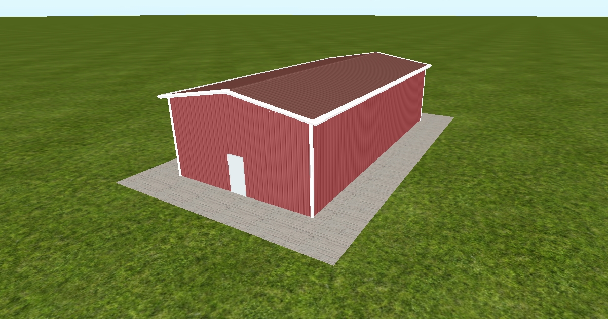

Juiced06GTO brought up some good points. A friend of mine that lives in Florida enlightened me to a different building approach. He says in Florida they have been putting up large metal buildings and then putting up a smaller building inside the large building that is heated / cooled and well light for doing all there fabricating and wrenching work in. The rest of the space around the smaller building is secure and used for vehicle storage. The added benefit would be having the town look at your large building when it's completed and signing off the project. Then build your smaller building inside afterwards for reduced taxes.
Mueller has some low costs steel building kits and a design your own option.
