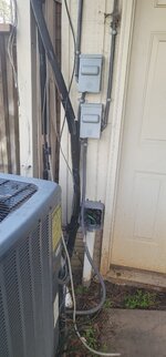

Here is my meter. It is split here, 200 to the house, 90 to the garage. I couldn't bury the garage wire so I ran it inside the attached garage.
It's easy to access in the garage. I just have it running along the wall. It then exits and I had to change it to aluminum underground wire. I already have two ac disconnects here. This is where I want to put the mini split disconnect.
View of the garage from where the garage service exits the house.

Looks like you can put another breaker at the meter.
Btw, you have a few issues with your existing wiring....
Post a pic of your panel in the house.

You're mixing a whole bunch of concepts up and your "electrician" did subpar work.
It appears you have aluminum SER running from you panel, through the wall and subject to damage where it is exposed in the garage. Then it is transitioned to ?? In a box that is too small and possibly connected to plumbing PVC.

This is already a sub panel, your main panel is at the meter. You can either get another breaker in the meter (and either run a sub or straight to the mini split) or install a sub off the panel indoors. For example, you could come off the top right breaker into a small second sub panel, and move the furnace to that new sub.
