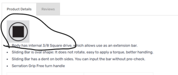

I'm interpreting the Koken ad as claiming this feature:
I missed that looking at my phone.

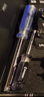

I've got a 1/4" T handle w/o the internal female and never use it. I generally grab a 1/4" spinner handle when I'm using a 1/4" ratchet, especially with the carb.

Wanted to bring this back up as I started going on the hunt when another member posted about buying a Koken 3/8" spinner handle. Unfortunately, those don't have a female end in the handle. Like already mentioned, the hard handle Snap on was discontinued.

Just picked this 3/8” spinner up from McMaster. Clearly a Mayhew product, but not identified as such. Nice beefy handle, but no female drive the end for those who desire such.

Neither of my 3/8” spinner handles have female drives. I have a few 1/4” spinner handles with female drives, and I don’t think that I have used the feature more than twice ever.IMG_4944.jpeg

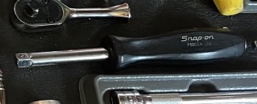

I've never owned a spinner handle with the socket on the back. And although I just ordered one for the heck of it while ordering some other koken spinner handles.
and I really like that particular snap-on handle In the picture.
It is really long. I wish that it was 2” shorter. I would like one with an 8” OAL.

I've had this guy for 30 yrs. I use it on almost every job. I think it's no longer available, but maybe you can find one on eBay. The part no is F50CSA. I often use it with the stubby shown above it.
Also don't understand the need for this to be impact rated.
I semi recently bought the 1/4" version of this. I like that and use it, but somehow this is better. Maybe because the handle is fatter and easier to apply torque to.
