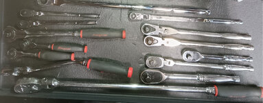

WWheeler
Jun 23, 2015
4,105
Middleofnowhere USA
Most of my ratchets are luxury items. Yes, nice, but I was able to complete jobs with MUCH cheaper ratchets before I had them.
The SHLF80A is a game changer. It's allowed me to do things I couldn't do before I had one. Not just lugs, but other stuff I couldn't fit a gun onto. This is one of only a few tools I think are worth whatever the manufacturer asks. That said, ratchets are smart buys second hand (eBay, etc)
Exactly.
Sometimes you gotta bring out the big dawg.
