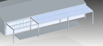

I was going to suggest a porch is not something to learn welding on, but I see you are expericed.
What kind of porch design will this be? Needs to be rigid enough to handle wind, a guy with a ladder leaning against it and walking on the roof. What about foundations?
Is it going to be all welded in-place? How are you getting the welder up there? Using Mig/tank setup? Maybe use Flux core? Holding the beams up temporarily against the columns is something to think about.
Just few thoughts.

I'm definitely not inexperienced, haha.
I can share my design later when I get home. Its 12ft x 60ft long, detached from the house for insurance reasons.
Uprights are 6in square tube .188 wall x8.
Crossbeams are all 3in x 8in .188 wall. Was originally going to go with 14ga wall for the top but the wife wants to hang chairs and benches and stuff. I also have an in so got the material for a good price.
it will all be welded in place and I'm currently debating bolting to piers, or burying 2 or 3ft and concrete in place.
I have a skid steer and will probably rent a lift to hoist stuff up, not sure yet because the crossbeams weigh 293lb per 20ft section. . . . Haha

Rough concept of the porch. 60 x 12, aprox 20ft between columns. Hopefully its stout enough.
