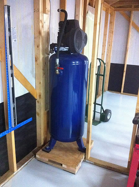

I have an Ingersoll Rand T30 on an 80 gallon tank. The slower speed of the two stage pump is easier on the ears. I like this compressor. I bought the tank and motor on Craigslist and the pump at an auction. I am out of pocket, if I recall, about $300. Some assembly was required.
These deals show up every so often. I like to gather the pieces as they become available. Patience.
Like the cows say, this thing really MOOOOVES air
