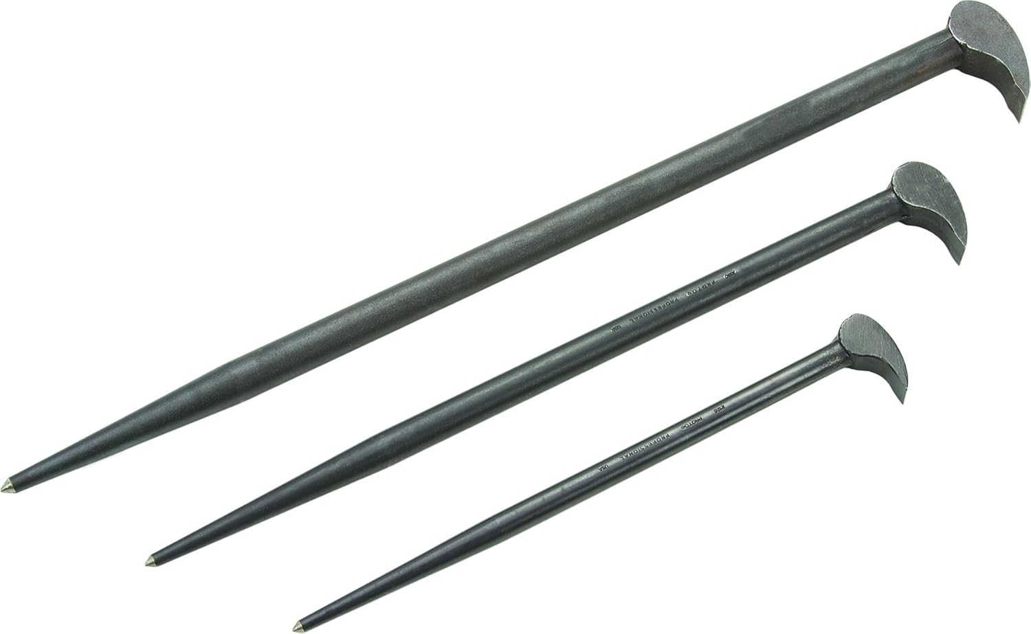

^ Alright, how about a pry bar with a striking cap? It'd be a heck of a lot cheaper than a bearing splitter set anyway.
