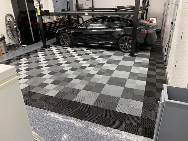

I'm on my 2nd Racedeck Free Flow floor - 2 houses. Used my first for years, then sold it and it's now making the 2nd owner happy.
I'm in Indiana with snow, sleet, salt, etc. Never got dull, never had an issue with noise walking or driving, loved every second of it. Here's house 1 (black with red/white) after years of use and my new house (black/white).
Get the RaceDeck, YOU WILL NOT BE DISAPPOINTED!
