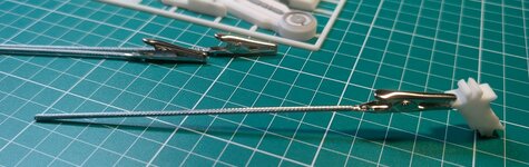

Gentlemen, I use these clamps attached to a short piece of cable (2mm dia.) to hold small parts.
I'm concerned about fraying at the end. Is there a solution?
The holders are placed in a rack (2.5mm).

Thanks for the replies.
I think solder & end sleeve would be too bulky to insert back into the holder.
But heat shrink? Why didn't I think of that. Dude, I love you want and a million of your babies :LOL:

I usually hit the end of the cable with the TIG torch for a split-second--just enough to fuse it.
Last time I changed a rear derailleur cable on my mountain bike, and didn't have any of those little aluminum caps you typically crush over the cut end, I looked over at my TIG and said "I bet I can make that work..." and it sure did!
We used to solder them. Works fine and doesn't increase the OD at all--if you know how to solder.
Mostly I work with stainless wire rope (when I work with wire rope at all) and there the TIG is much better.
