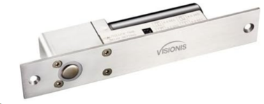

I am trying to hook up a drop bolt lock on my office/gun room door so the little ones can't easily get in, and so I don't have to carry a key with me to lock it everytime I enter.
I have the power supply hooked up in the basement, I also have the wires running up into the wall and the key pad and exit button boxes installed. I have also installed the drop bolt solenoids into the door frame. The last thing I need to do is connect it all together, but for some reason it just isn't as clear as I hoped it would be. I don't currently have a battery back up and want it wired so the drop bolts release if the power goes out, that way I can't get locked in my office.
This is the equipment I have, and the wiring diagrams for each. Can somebody please break it down for me on exactly which wire connects to where?

When the bolt is unpowered will the bolt go to the locked or to the unlocked position?
The first drawing makes it look like unlocked.
The second and third drawing make it look like locked.

Black to COM
Red to NC
If you do not get the door closed before the timer runs out and the bolt drops will it stop the door from closing?

There is a magnetic plate mounted at the top of the door. The bolt will not drop unless it senses this plate, which can only happen if the door is closed. Otherwise the bolt will not drop.
I got confused when you said “magnetic plate” I thought about the door holder magnet.
You also need a magnetic switch in the circuit to keep the bolt retracted when the door is open.
This wire is not shown in the diagram but the switch is built into the bolt. You will need to connect the Yellow wire to the open connection of the power supply.
Walta

Well I've tried this multiple times in multiple different ways, and I am just too damn dumb to figure it out. It actually worries me because a few years ago this would not have been so confusing.
I appreciate the help, but I think I need it dumbed down even more. The problem with the first wiring diagram is it does not tell you which output on the keypad connects to the Push terminal. So if you could dumb down to a crayon drawing level:
+12V from the power supply goes to the 12-24v (+) terminal on the keypad?
GND from the power supply goes to the AC/DC(-) terminal on the keypad and one connection from the Exit Button?
Push from the power supply goes ________________ and the other connection from the Exit Button?
Red Wire from Solenoid goes to _____________________?
Black wire from the Solenoid goes to _________________?
Yellow wire from the Solenoid goes to ________________?
I do not have a Magnetic Signal as far as I know. So do I use the blue and white wires from the solenoids? If so?
Blue wire from Solenoid goes to ____________________?
White wire from Solenoid goes to ___________________?
Am I missing anything? Again, thank you for your help.
Innovate1
Jul 28, 2014
4,315
+12V from the power supply goes to the 12-24v (+) terminal on the keypad? Yes
GND from the power supply goes to the AC/DC(-) terminal on the keypad and green wire the Exit Button? Yes
Push from the power supply goes _NO of keypad____ and the other green wire from the Exit Button? Yes
Red Wire from Solenoid goes to ___NO on pwr supply__________________?
Black wire from the Solenoid goes to ___GND on pwr supply______________?
Yellow wire from the Solenoid goes to ___nothing_____________?
blue and white could be used for the magnetic switch that detects door is closed (if you have one). Otherwise leave disconnected. Even if you have this switch you could get the rest working first and then add the door switch.
Connect COM to +12V on pwr supply.
The diagrams for the door bolt aren't consistent. The upper left diagram show 12V always applied and the keypad or exit switch triggering the yellow wire. The lower right circuit shows them interrupting the +12V line. Maybe either way will work. You may need to try both ways. What I wrote above interrupts power as shown in the lower right diagram.
Think I got that right. No guarantees...

Yesterday, all of my old wiring knowledge came back to me and made sense. My wife thinks I was just tired the past few days as I was starting this in the evening after working all day and just could not concentrate on it. Yesterday I started mid-day.
I used the keypad for the majority of the connections and only used the power supply for the main power coming into the keypad. This seemed to work the best. I also only used the power and ground connections on the solenoids, the rest were unneeded.
The setup now functions flawlessly, all the wires are hidden, and it is exactly how I wanted it. The doors lock instantly when closed, and open when a code is entered or a button inside the room is pressed just like I hoped.
