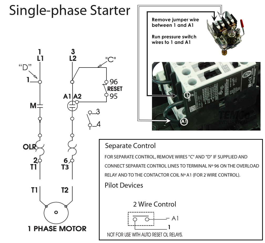

Just to be clear, I would wire the WEG starter switch you suggested to a Square D pressure switch like this?
Yes, the starter is connected to the pressure switch and the motor. This is generically how it's connected
Not exactly like that as what you are showing would use the pressure switch to short L1 and L2 ;)
But almost like that. I would have to look at the exact starter to say but the general idea is the motor power comes from the wall, goes into the starter then into the motor. The pressure switch is used to send power from the wall into a relay in the starter. So you are correct that the wall power, pressure switch and motor all connect at the starter.

Not to kick a dead horse but I'm sure there are or will be others with the same question.
I found a wiring diagram at WEGs site.
This seems to be the answer for allowing an external device control the initiation to switch.
