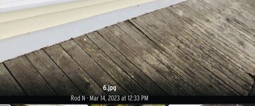

Hello,
I'm putting railing on the deck on the front of the house and need suggestions on covering up the boards. Trying to make it so water does not drip down below. Doesn't have to be 100% waterproof as it isn't now. I thought of ply and then vinyl, but that got expensive fast.
Probably going to sell in the spring.
Any ideas gents?

That's an unusual design. If you put a solid floor there, where will the water go? You don't want it pooling up on the surface.
My RE called it a catwalk. lol. There is flashing against the house that comes under the deck about 10". It is also slightly graded towards the front.

OK, then you can probably put a floor there. However I'd suggest maybe only making the area over the porch solid. It's an odd design. Unpredictable, really. It will probably leak some.

I've glued down rollout asphalt roofing and covered with outdoor carpeting on my friend's deck above his boathouse. The deck was plywood and pitched slightly from center out to both sides for runoff. I recall same thing being done with composite decking over firing strips (over the roofing) on some of his neighbor's boathouses.

It is the deck surface I am looking for. Something to go on top of the 2" x 6".

At least a few of those boards looks like they are split and rotted. Covering them up will only accelerate the rot. Do people ever walk on that surface? Might be a safety concern.
I have a nearly flat roof deck that is covered with plywood, then torch down rolled roofing and then composite deck boards. That is waterproof but would be more than you want to spend.
I bet that future prospective buyers or inspectors of your house will notice old boards up there and that could affect the final price or the ease and quickness of selling the property.

I replaced about 40 of the boards just before the snow (after I took the pictures) so they would weather a bit if I want to stain them when I put up the railing in the spring.
I thought carpet would create rot, but have found the opposite. There is a piece above my BBQ and the boards there are in better shape than the others. Maybe because of the weather coming off of the lake.
