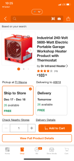

Hey guys I have a question that I am hoping someone can help me with. I have a 3 car garage with fairly high ceilings the outer door is insulated the ceiling is insulated in one of the walls is an interior wall the other 2 walls are outside walls that are not insulated. I am just wondering what is the best way to heat this space in the winter. I do not needed to be warm all the time but I would like something I can turn on when I want to work in the garage and it will heat up the area in about an hour. Currently I am using a propane tank with 1 of those forced air propane heater's which does work but it is loud I was hoping for something like an electric heater or even a natural gas heater I could install and turn on when I need to work in the garage. Let me know your thoughts thank you.

Unless you live someplace very cold (few places in the continental US qualify) your best option will likely be an electric minisplit.
  • More cost-effective to run than resistance heaters, and possibly combustion heaters depending on your usage and utility costs
  • Gives you AC and dehumidification in the Summer time
  • Eliminates the hazards and venting requirements associated with combustion heaters
  • Quiet, responsive, and uses utilities that your house is probably already set up to provide
Downsides are that installation can be a bit more complicated, you need room for the outdoor unit, and capacity falls off if your local temps are really exceptionally cold.

If you have the power available this is what I am running. Hard to beat bang for buck IMO. I have 2 ceiling fans that really help circulate the warm air in my 24 * 30 shop. Tall ceilings, only the ceiling is insulated. I keep it 65 deg inside while I am working and it cycles on and off as needed. I even bought a switchbot hub that I turn the heater on and off with. I can turn the heater on from my phone an hour or two before I will be out there to get it warmed up.

To take the edge off, I added a similar 240v electric heater like above. Its not cheap to run, but it heats up my 500 sq ft garage pretty fast.

It really depends on what you want to do. It's almost pointless to install a heater without insulating those other two walls. You'll waste a lot of money otherwise. My problem with propane is all the moisture it induces which is not great for tools etc. I have a King 5000 watt electric heater in my 390 square foot insulated garage and it takes about 45 minutes to go from 20-60 degrees. It's loud though and annoying when it keeps turning on and off while I'm out there. I just put a mini-split in my new 576 square foot second garage. I leave it set at 64 and its a revelation. I'm still shocked at how quiet it is. I'd never use anything else again.
Bottom dollar, don't mind an open flame and have NG or propane, I use these, you can wall mount them and plumb them for gas:
They have low oxygen detection, have thermostats... Not loud at all.
Electric works too, but you may need a 240V heater. Have the available power in the garage?
