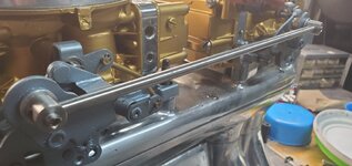

I've got a tunnel ram on the 454 in my boat. I need two new pieces made for the throttle linkage. Very simple pieces, I just don't have a lathe to machine them.
I will post pics shortly when I get home. I have stock I can send to make them from and I will pay for time/materials needed. I'm not looking for a hand out, just a hand.

Pics. I can do the drilling/threading, just need the overall diameters turned/parted.b9f8e08208ebad35e5d841ebd813834e.jpgce65c1f7162838877fe86fde3c8b3cfc.jpg013bdb256bacb143cd30b53eede250e3.jpg7ecc182baab83e92bf6e6a997996b7c3.jpgef564f3310d9ab558c4aa817af2f3e9d.jpg

Easily made without a lathe or drill press for that matter. Drill the 1/2" dia. stock and silver solder in that stud (bolt). Assuming those are standard threads, file off the stud threads not needed. A hand drill will do it all, a DP will make it easier.
A groove if needed, can be done with a hacksaw, drill running.

Material type? Something relatively machinable (plain steel or non-hardened stainless) or something not readily machinable (carbide or something else really hard or hard to machine)?
Rough tolerances?
Fillet radius where the 3/16" dia section joins the 1/2" dia section?
You -might- be able to take a piece of 3/16" round bar (.1875" dia) and do a shrink fit into a 3/16" hole drilled in your 1/2" dia main piece. Just a possible option.
And those threads on the 3/16" section look 'funky'.

Where you call out .18" dia is that going to be threaded? It would be better to call out for tap drill size or thread size on the male part. .18" is not close enough for good threads or a hole to be tapped 3/16.

All threads are 1/4-20. From what I found a 0.1887" rod will thread to 1/4-20. So maybe that dim. should be .19 instead of .18.
I had thought about a stud welded/threaded on, but this will be the main link between the two carbs and I felt that a single piece would be stronger. The old pieces were a single piece and worked great until I boogered the threads all to hell.
I overtorqued the nut slightly and after that it was a nightmare to get the piece off of the carb without messing up the carb, that's why the threads look so bad. A stripped nylock nut is hard to remove in tight quarters.
The shaft between the carbs is inserted into the larger through hole and cinched with a 1/4-20 set screw then I have bushings that fit the stud side and a nut sandwiches all of this around the large hole on a standard Holley throttle arm. I wish I had a better pic to illustrate the mounting.

I would make that part from 303 stainless or brass since it's in a boat. That looks like a nice boat don't want rusty parts. The part you dimension at .188 needs to be closer to .250 for a 1/4-20 thread and the shoulder length may or may not matter depending on the way it attaches to the carb. From personal experience I would make the area where the setscrew clamps the linkage somewhat thicker since they often strip out.

My HS shop teacher would beat me. I guess I've been looking at the minor diameter instead of the major. You'd think as much as I work on old iron repairing threads/studs I'd have caught that.

So, I don't mean to mess up the direction this is going, but if you use a loctited setscrew for your external threads it a) saves time over single pointing which can require a live center for support and b) you get perfect rolled threads instead of certain materials that like to tear at the crests. The rolled threads are stronger than the cut threads on any day of the week. If you don't like the internal hex it can be carefully parted, belt sanded or zipped off with a dremel and then face the end back to proper length and Higby the lead thread for self-cleaning.
On that part there isn't a lot of "meat" for the setscrew to grip but its just a thought that relates to those type of parts.

While those are Mr. Gasket's, I'll have Mr. BuffetFan's stainless bushings installed this weekend. :D These things look great from the pics, can't wait to get them and set them up on the tunnel ram. They should outlast the boat.
