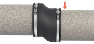

My son bought an old house here in central Texas a couple years ago. He’s had sewer problems a few times once he’s been in the house. Most recently he had it cleaned out by a plumber and the plumber found this hole in the line about 25’ from the house. The plumber told him he should replace this line from where the new PVC is by the back of the house to the street for about $7k.
I went over there yesterday and dug around the hole. It looks like maybe a tree fell on it at some point and poked a hole in it or who knows what. This pipe seems to be oblong here. The whole line from the fence to the house appears to have been dug up at some point. You can make out a distinct divot in the yard from the house all the way to the fence at the back property line.
I’m puzzled as to what this sewer line is made from. At first I thought it was metallic but it isn’t. Seems to be plastic of some sort. Maybe ABS? I put a section of rubber union on it and clamped it down as a temporary fix.
Anyone know what this pipe might be made of? What’s the best way to make a permanent repair? Thank you!

Fernco makes couplings rated for under ground that looks similar to what u installed. Box stores and plumbing supply should carry them. Need a fill piece pvc should be the same dimensions.

Use a Fernco with a metal shear band if you have to for a buried repair. It rigidly connects the pipes so they can't slip out of being aligned.
NO Shear Band
WITH Shear Band

It looks like it will need replacing at some point in the future, or possibly lined to keep it in service. I had a cast-iron pipe rust out after 40 years, and it cost about the same as the quote to replace it with a Schedule 40 PVC pipe.

sometimes plumbers bust holes in a line like that to put a blade in to cut roots. The rubber clamp is fine as a temp fix if properly tightened, especially if the roots are still somewhere in the line that will need cutting again. I'd put a box there to access it until a time when money allows a new high quality line replacement designed to keep roots out.

Thanks for all your replies! After reading about Orangeburg pipe, I'm pretty sure that's what it is. I suppose my temp fix will have to do for the time being. Maybe when I can get my sons and their brother in law around at the same time we can dig it up and replace it with PVC or ABS. Much appreciated!

Agreed that it is tar paper pipe. And agreed that it needs to be replaced eventually.
Being able to dig that up and replace it on your own schedule, and not as an emergency repair, will be a lot cheaper.

If you dig it up, I would do 10' at a time and lay the new pipe into the witness marks of the old pipe. That way, you don't have to be concerned with the slope, since the new pipe will be an exact replacement of the old pipe. Depending on the depth, you might want to rent a mini-excavator to remove the top and hand-dig the rest of the way down.

Depending on the diameter, you may be able to dig up each end remove a few feet and shove thin wall sewer pipe inside.
The type of pipe he has isn't stable enough to work with. It will crumble as he is removing it. The only thing that I could recommend is to have it plastic-lined, but that is an expensive method to save a decaying pipe. I would be inclined to believe that the pipe is at least 50 years old. My folks had a pipe in their home built in 1948 that had to be replaced in the 1960s.
