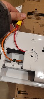

Now Its the heater part that has me a bit perplexed. Here the pictures and the instructions:
The instructions say to open the junction box on the end and connect the wires. so on the one end the junction box on the back has an orange and red wire connected together, the junction box on the other side has red and black wires connected together with a wire nut.
The colour of the wires and vaughness of the instructions is sort of throwing me off.
Best I can figure I should leave the junction box with the orange and black wires as it is and be conncecting into the other side with the back and red wires. I'll connect The ground wire to the ground screw, of course.
The question is does my hot wire from the thermostat go to the red or black? (neutral would go to the other wire, I guess) i'm thinking, the hot wire (coming from the thermostat) might connect to the red and neutral to the black on the heater but I'm not sure.

You can wire to either end of the heater, use which ever is more convenient.
Red, or black does not matter which one gets line or neutral. The thermostat should go in the hot line, not the neutral.
The tag clearly says 120v. No reason to doubt it.

Ya, the wire colours is what threw me off also, at first I thought there was a mistake and I had been given a 240v heater, but both on the box and the sticker on the heater say 120V, so I guess the manufacturer just doesn't use the standard 120V wiring colours of black, white and green(ground). And the instructions for the heater were also not the best!
Thank you kindly for the advice this is also what I was starting to think also, so I will give it a try.
