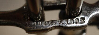

Hey everyone got another one for you to help me identify.
On one side it says June 1897 the other side says Oct 7 188?
Thanks in advance for any help

Oct 7 1884 is the only Tuesday in the 1880s, and I don't see it there.
Parsing out June 1897 into any Patent in June of 1897 drew 98 patents, none of which look familiar, and Jun 18, 1897 was a Sunday.

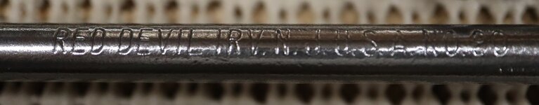

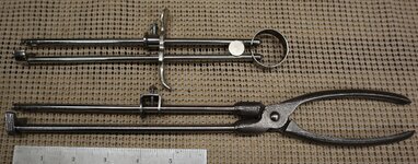

I used to use these for boiler condensate tanks. Typically the tubes are bought three foot long and you just cut off what you need. The glass isn't bothered by boiler compound chemicals. They do get dirty though and sometimes replacing is easier than cleaning. Here are two I have. Top one just has the two patent dates of June 7, 1892 and Oct 4, 1892. The first one is Jonathon Fowlers 476626 patent which covers the cutting end. The second patent is Arthur Chesterton patent 483778 for the rest of the design.
The other cutter I have is a Red Devil IRV N.J. #90. Cutter is similar to above. Plier grip to close. Both these are set for a 4" tube length. Typically tubes are in the 4" to 6" range.
