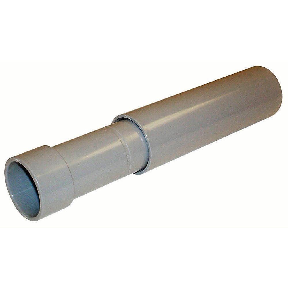

The ground somehow shifted enough over the last few years to snap off the pvc fitting where my gate opener power feed enters the panel. Eventually the insulation wore through enough to pop the GFI.
All the dirt in the bottom of the panel is from the nest I removed from the mud daubers that came in through the open knock out.
So, I guess check all your small conduit fittings more than once a year.

Nope, the conduit just goes straight into the ground then about 10 feet over to the gate.
Maybe the horses or cows got curious and rubbed against them, or more likely just walked next to it and compacted the soil.
Hard to tell from the picture but the conduit is more than an inch lower than when I put it in about 4 years ago.
If I had to do it over I would have put more effort into running it closer to the big conduit.
I will leave more of the cable jacket intact within the panel this time so if it happens again the inner wires won't be as vulnerable.

Yes, I’ll be replacing the top foot of rigid pvc with a liquid tite for flexibility. Otherwise I’m not sure I could even get the repair into the panel.

Are you experiencing freeze/thaw cycles where this is (Austin?) these last few years?
Our ground moves significantly every fall and spring proportionally to the moisture content of the soil. It expands in the fall and contracts in the spring, something most of Texas isn't used to seeing. It's powerful stuff and will destroy just about anything that isn't designed to accommodate it. It'll grab your conduit and move it vertically or sideways (with a lot of force). Cows seem like a more plausible explanation but freezes are becoming common in the south these days.

I agree with what others have said, using a slip joint type expansion section of the conduit right before it enters the panel will help alot. I believe the ones I used are actually supposed to be used to help repair damaged conduit in that you can collapse the fitting, put it in place and then expand to fit the damaged area. When I installed mine vertically right under the box on the house I 'split the difference' between the longest and shortest they are designed to be and they have been working well for the 4 years or so that I have had them in place. I'm in SE Wisconsin so we definitely deal with frost heaving issues almost every year.
Use an expansion coupling
