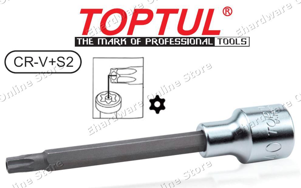

TOPTUL would be the way to go. Better quality than Husky, Kobalt, or Craftsman.
