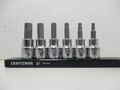

I picked up a set of the Dewalt SAE bits on clearance for under $10. And then this thread popped up and I picked up a set of the metric Craftsman for $17. I haven't used them yet but my initial impression is very good.
I'm almost certain these come from the same factory in Taiwan. The sockets appear to be identical except for the knurling and stamping. The production quality appears to be quite high, with nice chrome and very precise milling on the bits.
Interestingly, the 6mm appears to be milled down from 1/4" stock, and the 3/8" appears to be milled down from 10mm stock.

@Pexto those look nice. Almost wish I waited for the Craftsman. Probably 95% of the performance for 20% of the cost of the Proto RBRTs. Not sure how much I believe the marketing in the incremental improvements in the lineup.
Interesting that all the anti slip allen and torx bits seem to be Taiwan sourced. Have not been able to find a USA option.
Also didn't realize Grip Edge was an option. Looks like they are just as expensive as Proto here in the states. Can't tell if they are owned by SBD or licensed their patents to SBD.
