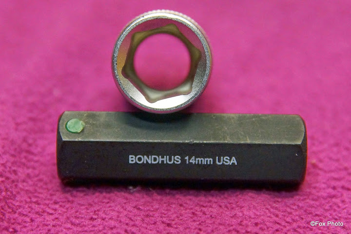

I have a Bondhus set that came with what appears to be some kind of hardened hot glue that holds the bit in place. Maybe you could try the same thing with your bits?
