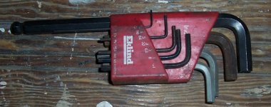

Sounds like you have a hodge podge of them like me Crow, replete with duplicates. You might want to spend the time to drill a block of hardwood for a custom rack, depending on where these will land for storage.
I keep my SAE in a smaller drawer in my 11 drawer roller dedicated to foldable sets, packaged sets and loose allens. a couple of the sets have plastic holders somewhat similar to a drill index, but open.
Yeah, I'm overdue to re-organize and size mine too... :lol:
The metrics are with the drawer of metric wrenches and sockets (which is now near overload...).
